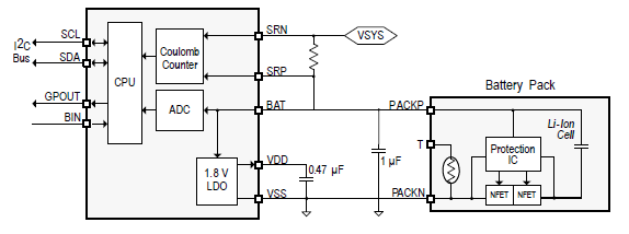

The new version of the Battery Chassis add-on for the Wio Terminal has added an On-Off button and a Texas Instrument's BQ27441 Battery Fuel Gauge https://wiki.seeedstudio.com/Wio-Terminal-Chassis-Battery(650mAh)/  .
The fuel gauge is a great feature that measures your battery's voltage to estimate its charge percentage and remaining capacity. The chip is also hooked up to a current-sensing resistor, which allows it to measure current and power.  The fuel gauge interfaces using I2C.  This will be useful to monitor the battery in remote datalogging applications.
TI BQ27441
There is a SparkFun Arduino library https://github.com/sparkfun/SparkFun_BQ27441_Arduino_Library  .  The library abstracts away all of the low-level I2C communication, so you can easily initialize the fuel gauge then read voltage, state-of-charge, current, power, and capacity. It also implements all of the chip's low-battery, and SoC-change alerts on the GPOUT pin.
Here is a demo of Battery Status display on the Wio Terminal during discharging (running on battery power) and charging (running and charging from USB).  I haven't quite figured out "State of Health" yet - it always returns 0%.  And I'm not sure why the full battery capacity is incorrect (it should be 650 mAh).  I'll need to read through the BQ27441 spec.  And I also haven't been able to get the correct schematic for the new Battery Chassis, but I've requested it on the SEEED forum.

    Interesting device. The datasheet on the BQ27441 mentions a Coulomb counter, which would imply that the charge and discharge currents (mA) are being used to accumulate the charge over time (mAH) to determine…

    Ralph, I have looked through the datasheet and through the SparkFunBQ27441 library and I am completely confused. The library does not seem to match the datasheet. There is a lot to be confused about, as…

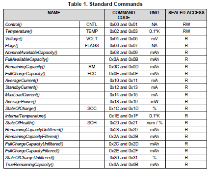

    Interesting device.  The datasheet on the BQ27441 mentions a Coulomb counter, which would imply that the charge and discharge currents (mA) are being used to accumulate the charge over time (mAH) to determine the actual battery charge state.  In a product that I worked on we did the same sort of process, with current and voltage monitoring, to drive a charge indicator (LEDs).  When properly calibrated we were able to get a pretty good readout of the remaining charge in the battery.
    TI has a white paper (slpy002) that describes in better detail their ImpedanceTrackTm algorithms, which appear to use Coulomb counting, impedance measurements, open-circuit battery voltages and various table to predict the battery charge level.  The Aging value seems to be based on long term changes in the measured capacities across multiple charge/discharge cycles, so you might have to wait a bit to see a change in that reading.
    With Li-Ion batteries, the listed capacity can vary widely compared to the actual capacity of the battery.  The displayed capacity of 584mAH is within ~10% of the rated capacity, so this is not too surprising.

    Thanks, I'll go read that white paper.  The thing that confused me - still does - about the battery capacity is that the program sets that value in a register using lipo.setCapacity(BATTERY_CAPACITY).
    I haven't seen any reference about how the fuel gauge uses that 650 mAh value that is programmed.  Likewise can't see a reference to how the State of Health is determined although from what I've read I'd expect a value closer to 100% for a new battery rather than 0%.  Anyway, still nice to monitor battery voltage and current.  I was able to get a new schematic.  I was hoping that the GPOUT pin would be connected to one of the MCU pins so that I could use it as a low voltage interrupt, but it only comes out to a test point so I'd have to open it up and modify it.
