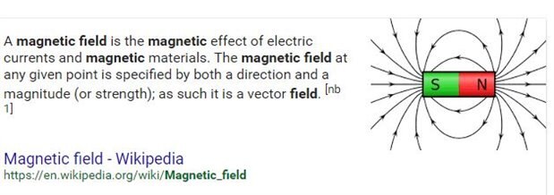

    Hi Les,
    The magnetic field lines, that are being generated by a specific amount of power (Amps times Volts), are part of a magnetic circuit that by convention comes out of the north pole and loops around to enter at the south pole of the field. As with all things in nature this path is path of least resistance. Each line of magnetic force is repelled by the adjacent lines of force while simultaneously being attracted by the opposing pole of the magnet. This is why we get the characteristic field shape of a bar magnet or a solenoid.
    Mathematically the line of force that comes out of the center of the magnetic field extends to infinity before looping back to the other pole but as D_Hersey correctly pointed out we have some form of inverse square law to deal with with respect to the intensity of the field as we go out. This makes the extension of the strength field dependent on the length of the magnet or solenoid to some extent and also the power that we put into the generation of the field. If you are looking for some way to focus the power of your solenoid's magnetic field so that you can project the magnetic effect an extended distance with a limited power source you have a very difficult engineering problem. The nature of the magnetic field is not amenable to this type of manipulation. I do not think that the converter will be of much help. For any specific coil resistance increasing the voltage will increase the current and thus increase the strength of the field but it will also create a commensurate increase in current draw from your battery. What I mean is that there will be no magic free increase in field intensity without paying for it with additional power input.
