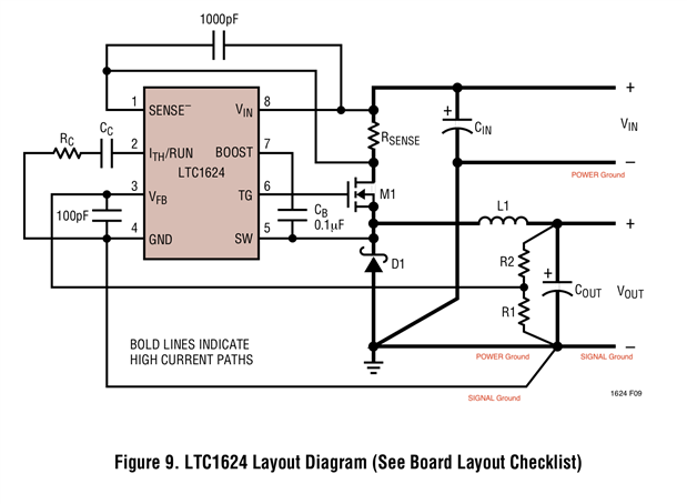

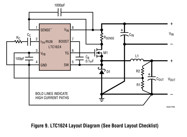

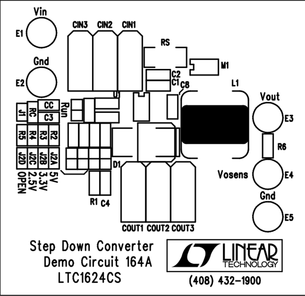

Hopefully someone can take a look and help me get some insight into what is being stated.  This is in relation to layout of a DC-DC switching regulator LTC1624 (for my power supply build).  The data sheet, pages 20 and figure 9 on page 21, seem to conflict or, at least, not make sense in respect to the reference made to power and signal grounds.
Layout instructions state:
  1. Power ground and signal ground must be segregated.
  2. Ground pin of LTC1624 must return to -ve of Cout.
  3. The resistive divider must connect between +ve of Cout and signal ground
  4. Cin must connect to Vin and Ground of LTC1624
(I've summarised somewhat but that's the essential gist - they make reference to a POWER ground and a SIGNAL ground).
Figure 9:
Looking at the layout figure 9, you can see that it follows these instructions and it would imply that -ve of Cout is signal ground; however this is directly linked to Schottky -ve pin, Cin-ve and back to the Vin - terminal

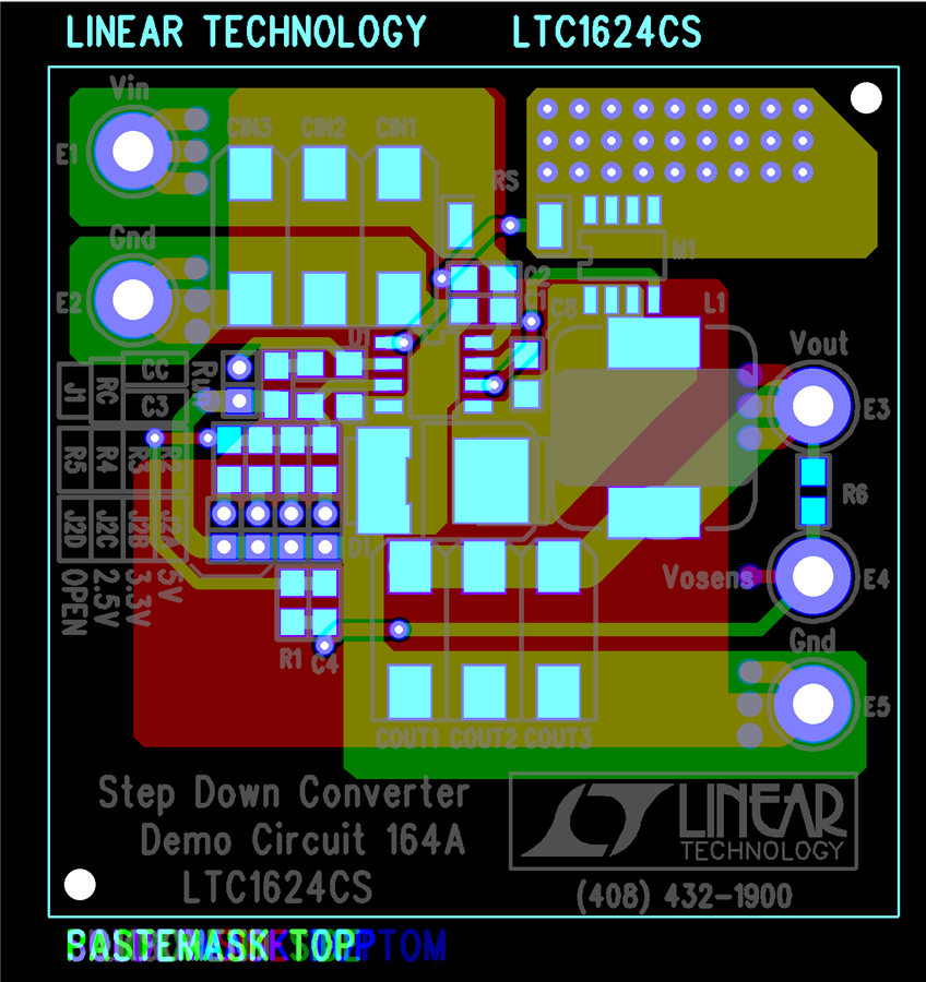

I've found a demo board for this chip. Unfortunately, the gerbers don't load into any viewer I can find, but there are images here on page 8 (last page.)
Silk Screen:
Component Side (top):
Solder Side (bottom):

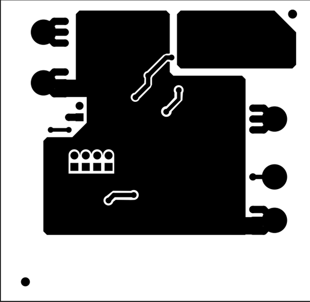

Looking at the Component Side (top) and Solder Side (bottom), there are two ground planes: a 'Z' like structure from Vin GND terminal E2, top left, under the LTC1624, to the Vout GND out terminal bottom right E5; the biggest copper area on Solder Side is Ground, also tied into E2 and E5.  I know 'Z' ground isn't a technical term but bear with me - I want to call it POWER ground but I'm not sure that would be right!  Looking at the Component Side silkscreen, it is clear Cout -ve is tied to the component side 'Z' ground; the feedback divider is also connected to the 'Z' ground where the sideways-U trace is.  It's worth noting also that the loop compensating resistor/capacitor is tied to the 'Z' ground.
Looking at Figure 9 and the PCB layout, it would seem that everything is tied into the same ground - it isn't clear if anything is tied into the ground plane on the Solder Side (except at terminals E2 and E5) and I've traced every component that has a ground connection to the Component Side 'Z' ground.  In other words, it's not clear what they mean by tying the resistor divider to signal ground.
Anyone who has been following along with my build will know I've right-royally screwed up the grounding and layout and I don't want to do it again.  It's been clear that I've not fully understood how Switching Regulators work so I've been doing a lot of reading and now have a better idea.  I understand why the feedback divider should stretch across Cout so why it is tied to the -ve of Cout and figure 9 actually makes sense to me (except for the ground symbol under the Schottky plus a link to Vin GND.)  What doesn't make sense are the layout instructions reference to Power and Signal grounds and the layout of their PCB - it would seem that the way both the feedback and compensation components are tied to the ground plane, right by Schottky, would be inviting noise and poor behaviour.  It's also tying noise onto the Vout GND terminal as well.
I'd have to assume that the PCB layout is purely for the purposes of demonstrating the functionality of the LTC1624 and is less concerned with the quality of the output.  Thus, I would expect that I would tie the Feedback and LTC1624 grounds to Cout -ve along a different Ground route.  That would also be the point for tying downstream ground components (so basically, like Figure 9 where the Vout -ve is deemed signal ground and Cout -ve becomes the star ground point for signal.)
Is this clear to anyone else?

    genebren over 7 years ago in reply to Andrew J
    Andrew,
    The easiest way to avoid having ground loops is prevent having loops.  This is done by radiating the ground traces away from a single point (i.e. star pattern).  You also need to separate paths of high current flow from paths of low current flow (while not necessary a loop issue, what you are fighting here is noise, introduced by the IR voltage drop).  Here is an example from a board that I am currently working on.  This board supplies up to 8Amps to external servo (up to 6).  As a result, there are some hefty traces for power (quite noisy).  To isolate the remaining circuits from noise (from the power/ground paths) a lot of efforts were taken to purposely route power and ground to the rest of the board.
    Gene

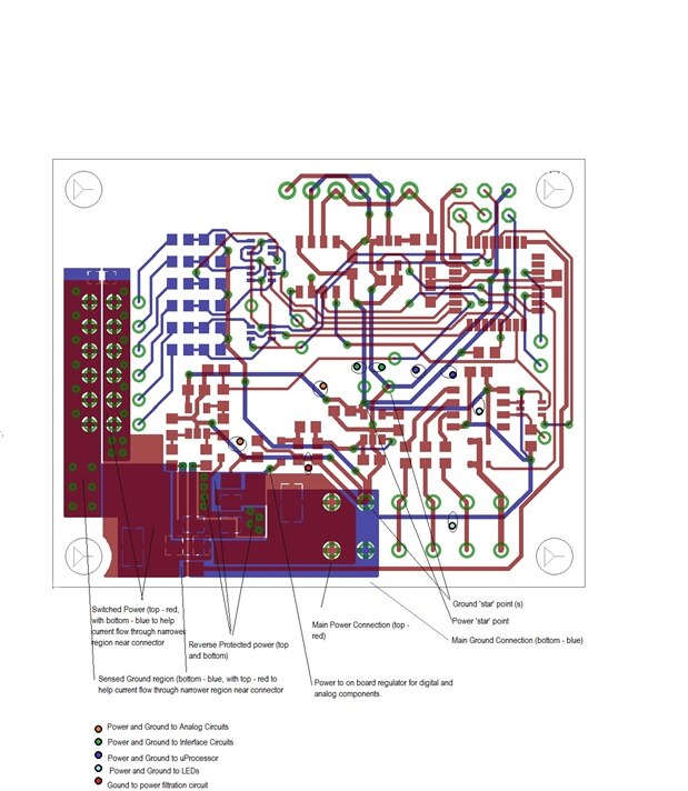

    Thanks Gene - I think I'm getting there.  Let me say again what I'm thinking:
    I'm going to go for a 4-layer PCB so I was thinking:
    Layer 1: High current power, low current power, components, high-current traces and high-current ground returns, Signal traces where I can keep them away from the high-current traces
    Layer 2: shielding ground - I may have misunderstood what this is, but I think it is a means to pick up noise from the high current traces/components and keep it away from the low current traces/ground/components
    Layer 3: low current ground
    Layer 4: low current traces when needed for routing
    Power connected at one point, power supply Vin+
    Shielding Ground connected at one point, power supply Vin-
    Signal Ground connected at one point, power supply Vin-
    High-current and low-current grounds are not connected anywhere except Vin-.
    There will be vias for low current components to connect to layer 3 and traces on layer 4.  It's also worth mentioning that a number of parts I'm using are through-hole - connectors I can leave at the edge which would mean 6 other components (possibly 4 as I redesign.)  At the moment, I couldn't state definitively that I wouldn't have to route high current ground returns on layer 2 as traces.
    Where I said above about routing the shielding ground away from sensitive circuits doesn't seem to make sense if I connect nothing to it.
    However, I still have one niggle: I thought the best way of managing ground loops would be to provide the return path directly under the source trace to minimise the loop area?  That of course would mean adding high-current ground traces on layer 2.
    Andrew,

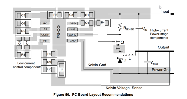

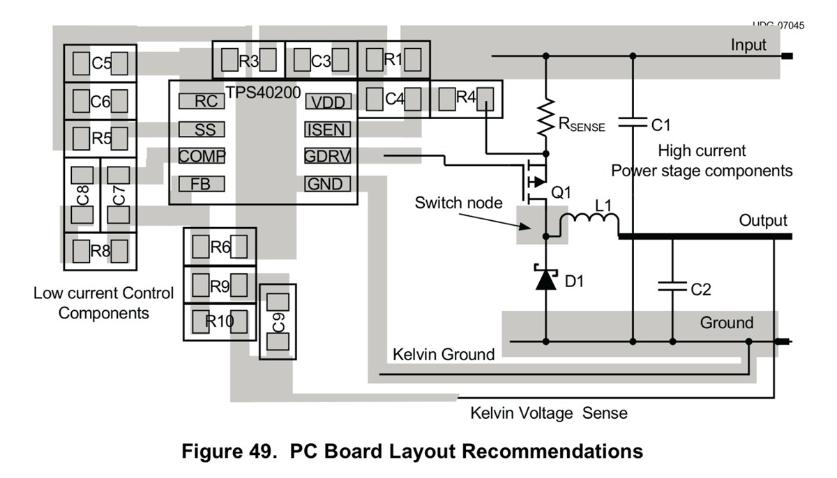

    Can I ask two further questions:  in the TI datasheet it says "Traces carrying large AC currents should NOT be connected through a ground plane. Instead, use PCB traces on the top layer to conduct the AC current and use the ground plane as a noise shield."  Does this mean that the high current traces, including Ground traces, should be on the top layer with a solid ground plane underneath to which nothing is connected, except where ground routing on the top layer is impossible and needs to be routed on ground plane layer? Here I'm imagining a 4-layer board with high current traces on top layer, then shielding Ground Plane (routed/split away from sensitive components), then signal ground plane, then signal traces.
    In the top image, the ground plane (both Kelvin Gnd and Power Gnd) are shown in a single trace.  In the lower image, the Ground and the Kelvin Ground are more of a starred arrangement, where the high currents are passed through the thick trace and the low currents through a separate (thinner) trace.  This is a simple start, but the situation gets much more complicated when the high and low currents are a part of the ground plane flooding, where the there is a lot of copper, but it begins to take on convoluted shapes and exists on multiple layers, inter-stitched.  Do the large paths need to be on the top layer?  Mostly yes, because that is where the components in the high current path are.  The most direct connection (trying not to use vias) is the preferred method of connection.  When thinking of a solid ground plane on another layer, again you need to be careful about the possibility of mixing high and low currents, so if you need to stitch connections, try and do it with traces and vias, not necessarily vias to a flooded plane.
    Both shielding and signal ground planes connected at, where, Cout -ve? Vin -ve?
    Tie them at a single point.  I usually tie traces at the input side (ve).  From the source side, I star out a low current path and a high current path, never allowing then to reconnect to each other.  If I am adding a ground plane (shielding), it is also connected to the ground at the 'star' point and again, never allowing it to reconnect to the other ground paths.
    Gene

    From your text extract, yes, I'd picked up from reading the TI stuff (and an excellent article from Micro-Rohm) that the feedback circuit must be kept away from the switching node - actually all sensitive circuits.  Clearly figure 9 for the LTC1624 has the divider smack bang next to the Schottky and Inductor - although it seems a little better in their evaluation board layout in that they are only close to the Schottky ground terminal.  It's interesting that a lot of the images I see relating to these switching converters having the compensation capacitor and resistor connected to the feedback pin.  The LTC1624 doesn't have this setup, instead connecting compensation to ground.
    Pictures of actual production pcbs are very useful so thanks for posting that.  I've been looking at SMD mosfets to close up the gaps - I can get one with similar/slightly better specs than the one I've currently got (through hole - which is a pain as the pin configuration is GDS rather than DGS) except for power dissipation.  I shall run some temp tests on a variety of loads to see what the score is: my calculations say it should be ok and the LTC board uses a misfit with the same low power dissipation.
    I'm going to go for a 4-layer PCB next as it seems a lot easier for only a small additional cost.  So I was thinking components, high-current traces and high-current ground returns on top layer, signal traces where I can keep them away from the high-current traces; power (shielding) ground on layer 2; signal ground on layer 3 and traces on bottom layer when needed for routing.  That should avoid adding traces on either of the ground planes and breaking them.  Route the power ground away from sensitive components - that will make it an unusual shape of course but 4 layers will allow me a lot more flexibility in layout than the 2 layer board I currently have.
    It would seem that from the image above, and what you note, that actually I could avoid high-current ground traces on the top layer and just stitch these through to layer 2.  That would seem to be against the layout advice TI give (which I quoted above) and also Micro-Rohm:
    Next, PGND is essentially laid out as a single line on the top layer (as on the left in Figure 8). However, as a result of component arrangement and the like, there are cases in which a single continuous line is not possible. In such cases, PGND may be broken up and connected on the rear surface or by an internal layer, using vias (as on the right in Figure 8). Due to the influence of resistance and inductance of the vias, there may be increased losses and the noise level may be worsened, and so actual device should be used for thorough verification.

    shabaz over 7 years ago in reply to Andrew J
    Hi Andrew,
    Looks like we were typing responses at the same time : )

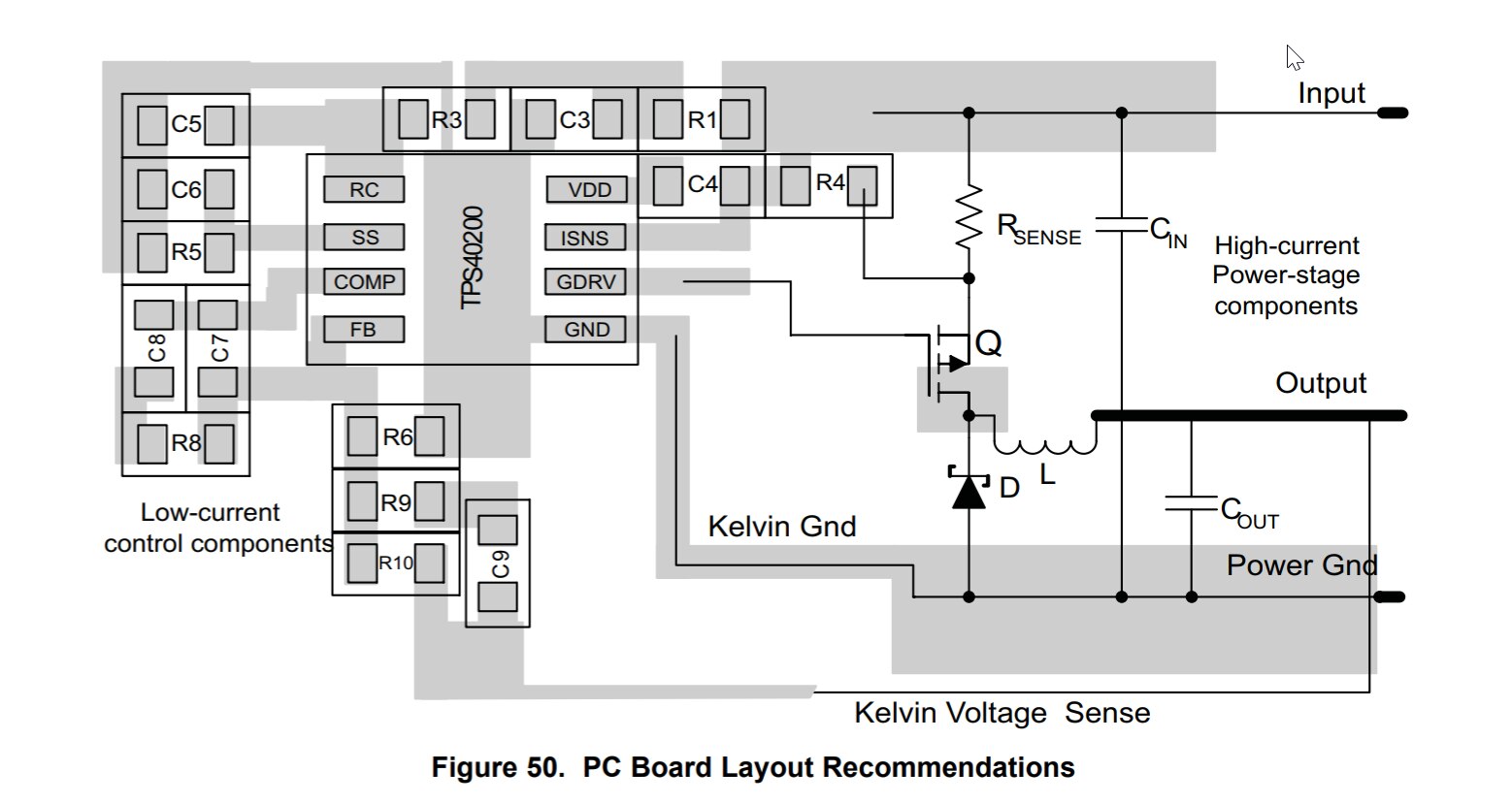

    Regarding shield, they're suggesting that since the top copper can be used for the traces that carry high switching currents, then a different layer can act as a shield to prevent that switching noise to affect other circuitry. To do that, it doesn't overly matter where that shield is connected (it would matter for RF).

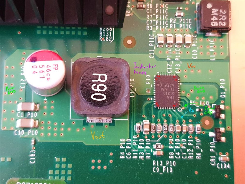

    Incidentally, here's a layout from a computer board, using TPS51315 (PDF doc) I like looking at PCBs just to see what the designers did : )
    It has integrated MOSFETs so the layout isn't the same, but again they have got the feedback node quite far from the high current areas.
    The power ground is definitely using another layer too, since the stitching can be seen on the left and the right side of the photo, but since this is a large motherboard it will have many layers, so shielding is still possible.

    That is helpful, thanks - I was trying to work out how the chip got power as VDD is connected through a capacitor and resistor, C4 and R4!  Checking the datasheet for the TPS40200, I think you must have an older version as it looks different in the version I saw.
    Anyway, it is useful and if you compare the layout with Figure 9 for the LTC1624, they are pretty comparable.  In this version, we can see that GND pin is connected at the same point as the feedback divider (and compensation loop) at Cout (or C2 in this figure.)  That makes me think even more that the evaluation board layout was not done with quality output in mind, just capability.  I guess without getting hold of one I'll never know, but I will contact LT and see if they can clarify, good suggestion.  The layout notes in the TI datasheet are way clearer as well.
    Hi Andrew,
    This text might help, from "Fundamentals of Power Supply Design" which is a TI book that I won in a competition a while back.
    It places the resistors away from the switching area, to keep them away from the MOSFET and diode, to reduce switching noise pickup on that resistor node.
    It agrees with the style of layout in the TI design mentioned earlier, but disagrees with the style of topology drawn in the LT datasheet.

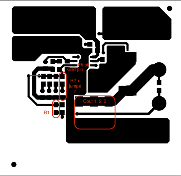

    I took a look at a different chip I've used in the past, just to see what the recommended layout is like. Here R10 and R6 form the feedback resistor divider:
    Perhaps that can give some ideas. Also it could be worth querying from LT directly, letting them know that their datasheet makes no sense. They are responsive (I asked them a while back concerning some other chip).
