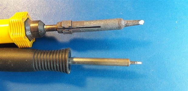

My first thought is, perhaps it's corrosion, from high or excess heat, these are disposable parts after all, but what really contributes to this kind of wear, and is there anything that can be done to prevent it being so sudden or so soon?
Often I find the soldering tips in the workstation to be bent, or the end of the tip looking like it's snapped off.
What're your thoughts?
How long do tips last for you or how often do you replace them?
What do you use to take care of your soldering iron?

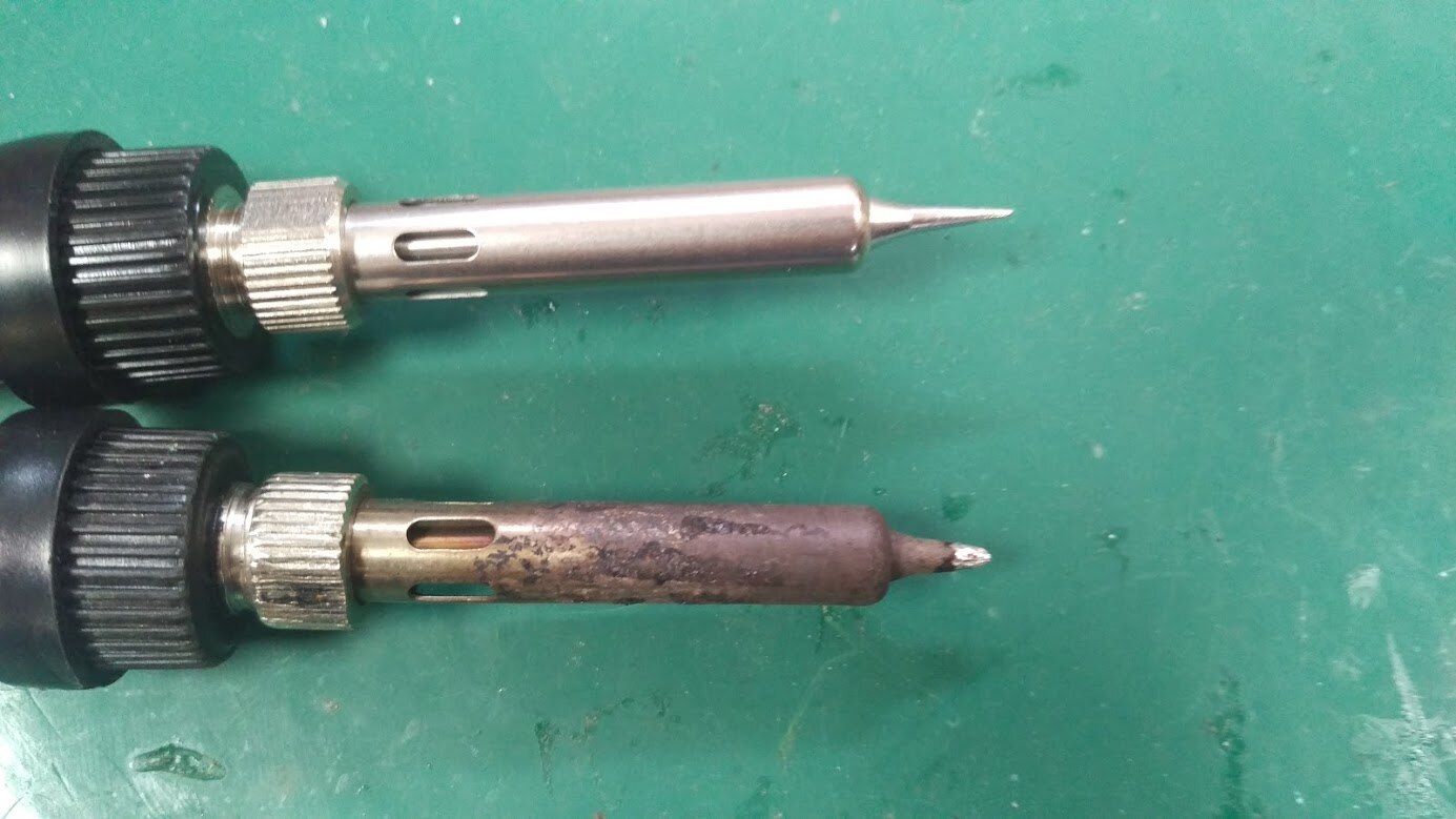

    That tip may have started out that short, they come in many different shapes and sizes. I have three different sizes I use: Short and fat = higher wattage. (usually) or someone has been cleaning the tip…
  • Gough Lui
    Gough Lui over 6 years ago +7
    That looks like a tip from a Tenma hot air rework combination station (rebadged Atten). I would know ... because I have one, along with a spare soldering iron assembly when element14 last had it on special…

    Jan Cumps over 6 years ago in reply to shabaz
    Here's a customer action photo of my irons.
    The top one is unregulated, bought when I was at school (I guess '83). It's only be used with leaded solder. Has seen a lot of use.
    The lower one is 2 years old, regulated. I use it with unleaded solder - 350-380 °C. Also seen a lot of use.
    My very first iron, an Archer, suffered from tip damage (there was a hole eaten into that one - that actually happened very fast image). Since then I never had structural damage to an iron.
