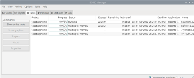

Then you can use either the GUI or Terminal version image

    This is the error btw:
    Rosetta@home: Notice from server
    Rosetta for Portable Devices needs 1907.35 MB RAM but only 1672.83 MB is available for use.
    Sun 05 Apr 2020 06:37:52 PM PDT
    So with raspbian it won't work maybe if I run lite version it will but will have to test that out.
  • gam3t3ch
    gam3t3ch over 6 years ago in reply to rstone
    even the pi 4 2gb running a os that is using it might say it doesn't have enough ram I tried it on my pi4 2gb with raspbian and got that error.   But does work on the pi4  4gb I think I will have to use ubuntu server on the pi 4 2gb to see if that will work.  and the 2gb it needs to be free not in use.

    You should now be able to run rosetta at home on the pi4 raspbian
    and get some jobs starting instead of errors.
    then you should see it running mind you memory can be a issue but this will get you started.
