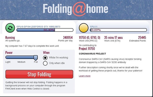

The Folding@Home distributed grid computing project has set its sights on analysing the Coronavirus.
Whether you have a powerful CPU or GPU up for the task, you should be able to contribute to dissecting the proteins involved and contribute a bit of your electricity bill and processing power to calculating the means necessary to analyse the proteins.
Download the client and set it up however you want to (whether you want it to pause when your processor gets too busy, too hot, or just when idle while you have the computer on).
You can find more detailed information here and here. There's a Windows client attached to this post.
Current Corona specific projects (you don't need to do anything to get them, the software will do it for you):
14530/14531 Coronavirus SARS-CoV-2 (COVID-19 causing virus) protease - potential drug target
14328 - Coronavirus SARS-CoV-2 (COVID-19 causing virus) protease - potential drug target
11741: Coronavirus SARS-CoV-2 (COVID-19 causing virus) receptor binding domain in complex with human receptor ACE2.
11746: Coronavirus SARS-CoV-2 (COVID-19 causing virus) receptor binding domain in complex with human receptor ACE2 (alternative structure to 11741).
11742: Coronavirus SARS-CoV-2 (COVID-19 causing virus) protease in complex with an inhibitor.
11743: Coronavirus SARS-CoV-2 (COVID-19 causing virus) protease – potential drug target.
11744: Coronavirus SARS-CoV (SARS causing virus) receptor binding domain trapped by a SARS-CoV S230 antibody.
11745: Coronavirus SARS-CoV (SARS causing virus) receptor binding domain mutated to the SARS-CoV-2 (COVID-19 causing virus) trapped by a SARS-CoV S230 antibody.
All these are under the default "any" selection in settings. We don't currently have a coronavirus specific selection, so all related projects will be grouped up and sent under the ANY setting to your PC as needed!

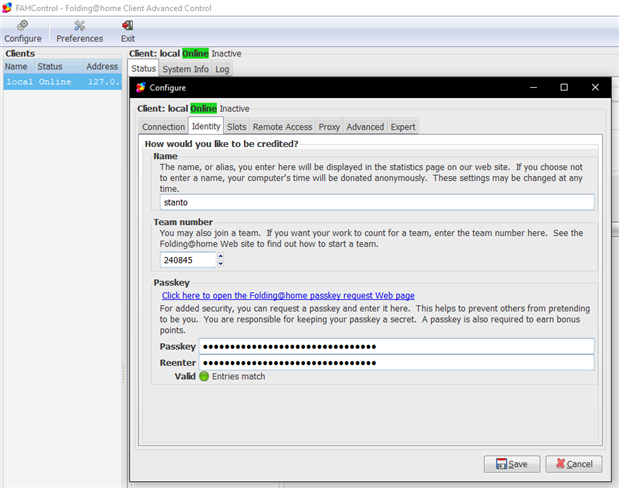

Join the element14 Community Folding@Home team - the Team Number is 240845
You should be able to request a passkey if you want to setup your own username, though it may take a while before you receive it via email.

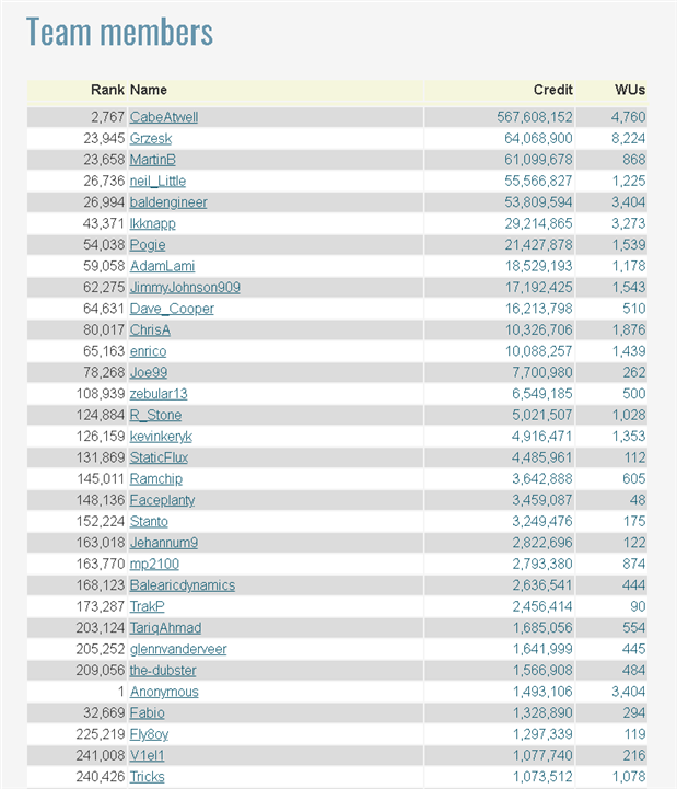

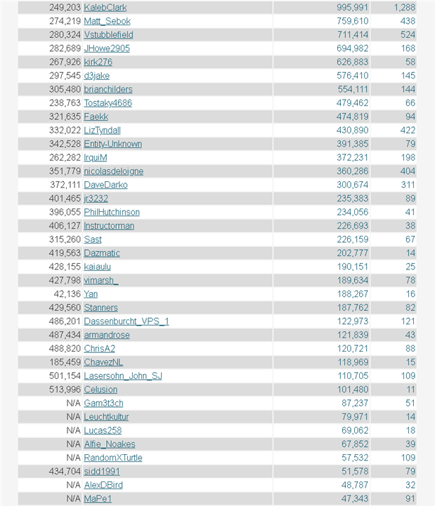

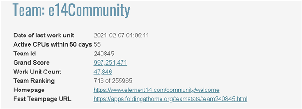

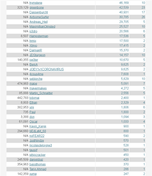

Edit: Now with STATS
We can view the element14 Community team stats here or here
Here's a snapshot of them as of 7th February 01:47 GMT

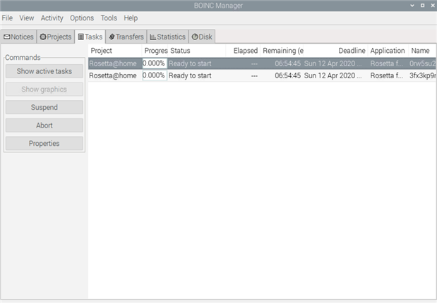

Picking up Work Units

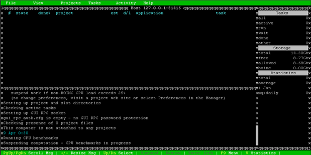

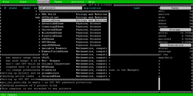

If you're setting this up over SSH (like I am) , or bring up a terminal in the desktop, type in:
$ boinctui
Then hit 'enter' at the first prompt. Then press F9
Using your arrow keys on the keyboard, navigate to the menu 'Projects' and hit enter on 'Add Project' and choose 'Rosetta@Home'
Choose 'existing user' because you'll have already setup an account and joined a team. Then type in your username and password.
Once you've typed in your username and password, the software will run a benchmark

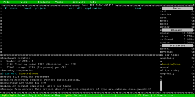

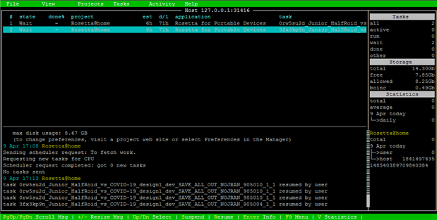

However you may not be able to run the Rosetta@Home COVID-19 work units in Raspbian because something in the setup of BOINC has gone awry or you haven't enabled arm_64bit=1 in config.txt and you'll get an error message like this:
"This project doesn't support computers of type arm-unknown-linux-gnueabihf". I encountered this problem and I had to do the following. Though I did have a better experience using BOINC Manager from the GUI rather than going for boinctui straight away. If you find that no matter what you do, BOINC still throws 'arm-unknown-linux-gnueabihf' then try running:
$ sudo apt-get purge --auto-remove boinc-client boinctui boinc-manager
Then say 'yes' to the prompt that appears, and then run:
$ sudo apt-get install boinc-client boinc-manager boinctui boinc-client-opencl libgl1-mesa-glx
Then instead of using boinctui, follow the steps using BOINC Manager which you'll find under 'System Tools' in the Raspbian desktop.

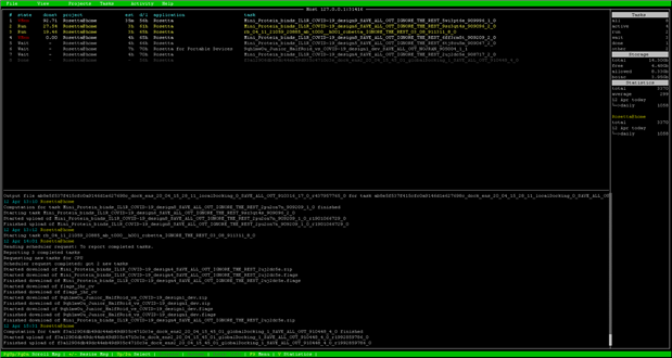

Then you can use either the GUI or Terminal version image

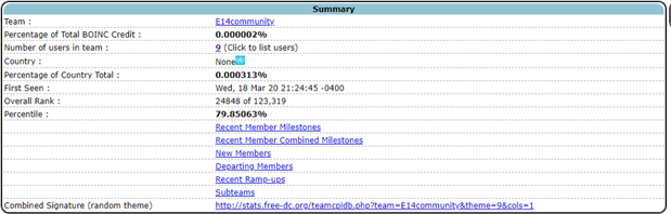

There are also stats for this team here and here ! Looks like it's only me so far image
We've just passed the 900,000 unit milestone on Rosetta@Home! Great work !

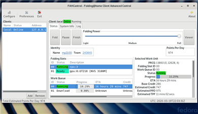

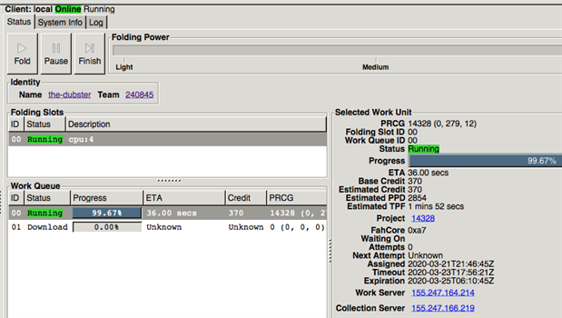

    My elderly 2.8 GHz Intel Core i5 is running CPU stuff ok, about 7-8 tasks so far (but still only shows 3 . . . . . )
    The aluminium case of the Mac runs to about 55 deg C with folding power set to Full . . . . .  all 4 cores running 85-95%
    The 2010 iMac has the fan (very quiet) and vertical motherboard with convection cooling (and I've never vacuumed it out).
    An i7 will have no issues.
    Edit, 13 listed, 14th finishing up and 15th queueing!
