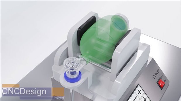

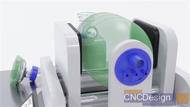

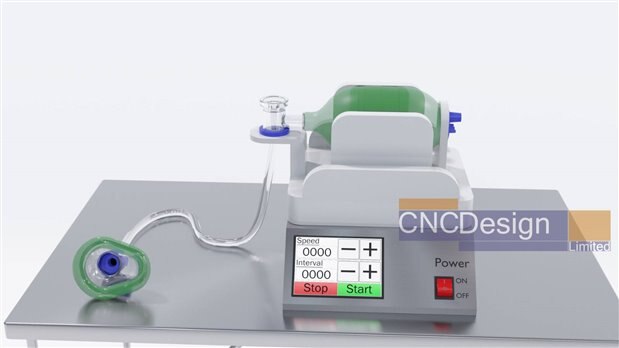

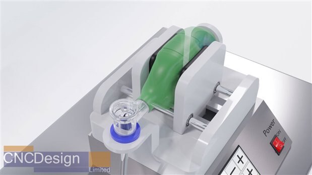

Please check out our concept video on this post.
Automating a readily available Bag Valve Mask (BVM), also known as a hand operated manual resuscitator.
This would free up the personal that would normally be need to operate a BVM.
The device could act as a stop gap in hospitals or at home where a ventilator is needed, but not currently available.
This is not a design to replace a ventilator that has a lot more features, but maybe a low-cost solution to help out.
At the moment we are looking to rapid prototype this machine in house at CNC Design and looking to work with medical professionals first to make sure that the design and use is a viable solution.
Please feel free to share this post.

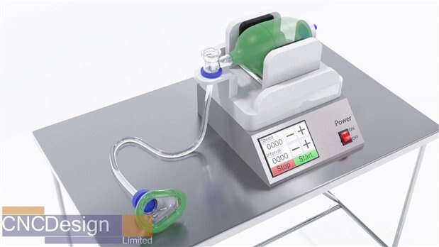

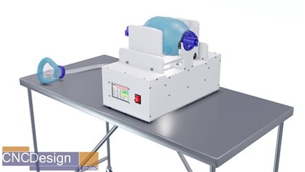

    We have now setup a dedicated domain for the Automated BVM at http://automatedbvm.net
    There are few more details on the machine and the CAD renders of what the actual prototype will look like.
    Not as pretty as the original concept, but workable.
    Also the inside of the machine is shown with working mechanics and minimal components as planned.
    We had the Acetal arrive today, so will be milling the plates out tomorrow image

    How many presses can that bag sustain before it breaks? I would look into how mechanical ventilators operate to get ideas on how to build a system from scratch. Also it's important to be aware that this industry is highly regulated because if the machine fails people die. Of course a flawed machine might be better than no machine at all, but still laws could make the implementation of non-regulated, non-proved, low-budget mechanical ventilators difficult.
