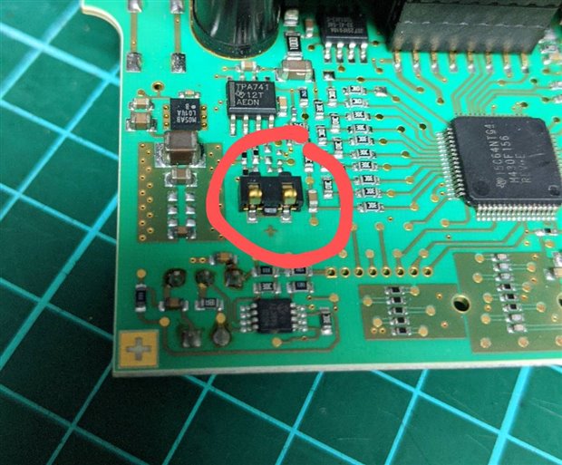

Hi everyone.
I need to replace part in the red circle, but I don't know its name.
Its connected to battery terminal by touch.
Please help..
Thanks.image

    It looks a little like:
    Product LinkProduct Link
    A battery compression contact but without a specific code it's not possible to confirm.  I suspect that if you can match footprint or bodge in place and it meets the voltage/current spec you could fit a similar product without making it a direct replacement.  Easiest would be to get it off the board to see what you are working with and then hit the parametric searches!
