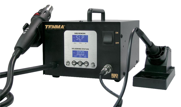

    cstanton over 5 years ago in reply to shabaz
    > Great job with the hard disk! What reflow station did you use incidentally?
    I likely meant rework rather than reflow, though I've seen the two used interchangeably.
    If I was able to access Leeds Hackspace, I would have used this:
    https://uk.farnell.com/tenma/21-10130-uk-eu/rework-station-900w-220v-uk-eu/dp/2062633
    But because I can't... and I have a limited budget, I bought this from aliexpress:
    Which did the job, though it has limits.
