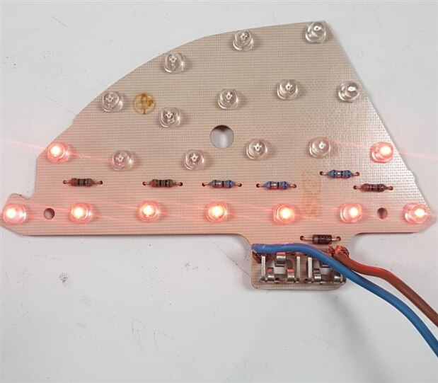

    My mini-success today was fixing something too, in this case remotely fixing a car rear light via video chat.
    A friend sent across this photo, he was using a bench-top supply to test it, and only some LEDs were lit..
    First thing was figuring out why he was measuring strange voltages with the multimeter - it turned out that he'd left the bench supply sense terminals disconnected for years! (He's not an electrical/electronics engineer and the power supply was a hand-me-down with no instructions) so the control loop was not happy...
    Anyway long story short, it was an interesting fault.. I'll leave a gap in case anyone wants to try to figure it out.. answer below.

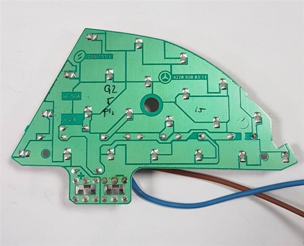

    Looking at the solder-side of the PCB, it was clear that the LEDs which were lit, were in chains of three and a resistor. There were three sets in parallel, for a total of nine lit LEDs.
    R1---LED1---LED2---LED3
    R2---LED4---LED5---LED6
    R3---LED7---LED8---LED9
    R1, R2 and R3 are the darker smokier resistors.
    However, the unlit LEDs were in chains of four, i.e.
    R4---LED10---LED11---LED12---LED13
    and so on.
    There is also a single diode on the PCB to which all the parallel chains are attached. Anyway, it turned out that there was about 5.5V across the diode.. meaning it was in a weird enough damaged state that there wasn't enough voltage to make the chains of four LEDs be able to be lit, if the PSU was set to (say) 12V. Replacing the diode fixed it of course.
