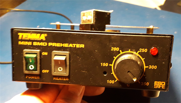

    Andrew J over 5 years ago in reply to dougw
    That's pretty much the model Jan and Shabaz has - they are all variations on the Aoyue 853 - and it seems they get on well with theirs.  If you search around for that Aoyue model, you may find it pretty cheap.

    dougw over 5 years ago in reply to Andrew J
    The Tenma is one I was looking at: Tenma PreheaterTenma Preheater

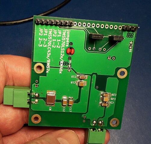

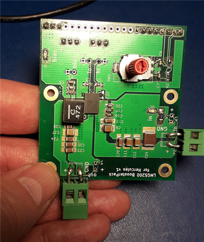

    Jan Cumps  wrote:
    The example below is an example with four layers with fill areas on each. QFN IC with a ground plane and a chunky (for SMD) inductor with the pads underneath:
    Self promo: It's a switch-mode power design - a GaN FET half bridge, switching at 1 MHz, 10 ns dead-band.
    An exercise to make a PCB with a "critical" feedback loop, following manufacturer's application note and gerbers as a reference: Hercules LaunchPad and GaN FETs - Part 3b: BoosterPack Layout - my version

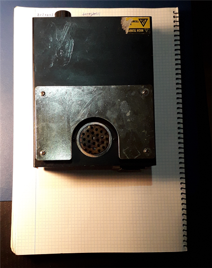

    Useful to know, thanks - that would be 100mm x 210mm so a pretty big PCB.  I guess you mostly do smaller sized boards though - do you find that it brings the whole pcb upto temperature without a hot spot above the outlet?
    The PCT-100 is 205x155 so slightly bigger. Although it doesn't give dimensions of the heating area it looks to about 2/3rds so approx 135mm; it's also 450W so a little less powerful.
    Jan Cumps over 5 years ago in reply to Andrew J

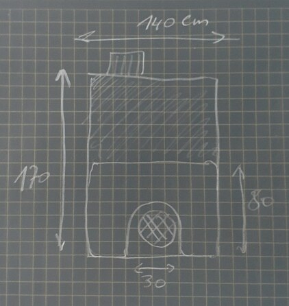

    TENMA 2064552, no longer made, but the Aoyue 853 is virtually identical.
    Foto of the top. On an A4 page for scale:
    Measurements:
    I don't know the exact measures of the biggest board. Approx: 1/3 of the height of an A4 page, width of an A4 page.
    edit: it says: 540 W
