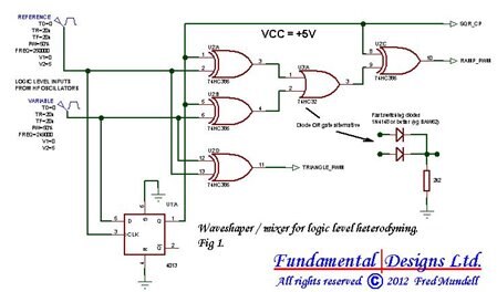

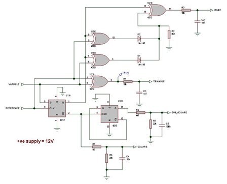

    FredM over 14 years ago
    Simplified version without CV control:  (further discussion can be found at Theremin World http://www.thereminworld.com/Forums/T/28592/coil-tuning?Page=4 )
