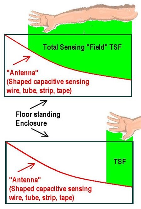

This is quite a major deviation from the theremin concept -
Put the "antenna" in a floor-standing enclosure (for example a narrow box) and shape the antenna to provide required linear response.
No antenna equalization would be required.image
