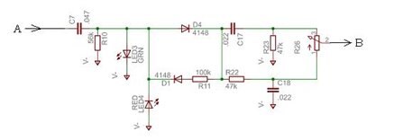

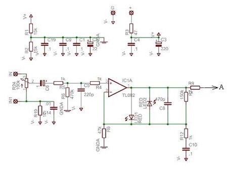

    Hi Rob,
    Just split your image so it can be posted at TW .. Hop this is ok. Fred.

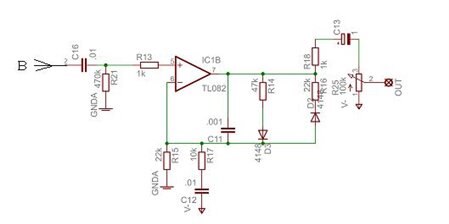

    e14 Contributor over 13 years ago in reply to FredM
    Audio filter based on a guitar stomp box.

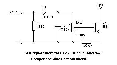

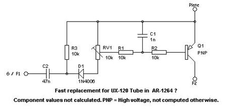

    Possible UX-120 replacement circuit (RCA volume modulator) ?
    Updated (simpler / safer)

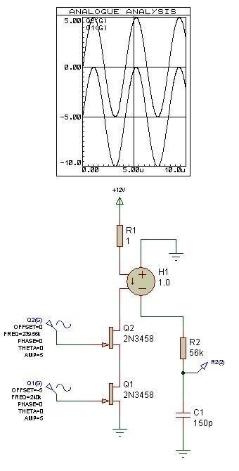

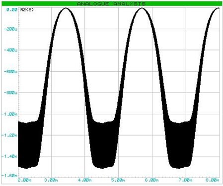

    FredM over 14 years ago in reply to FredM

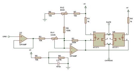

    Fets do not seem to optimally model the triode function -
    Here is an experimental circuit allowing adjustment for gain and biasing, allowing cathode-plate resistance to be better controlled.
    Slow H11F1 speed limits operation to lower frequency - amplifiers need gain to compensate for thisimage

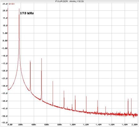

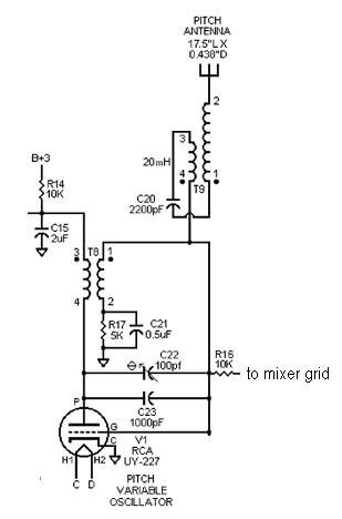

    Analysis of RCA oscillator
  • FredM

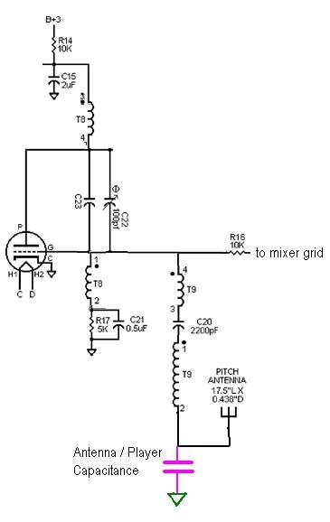

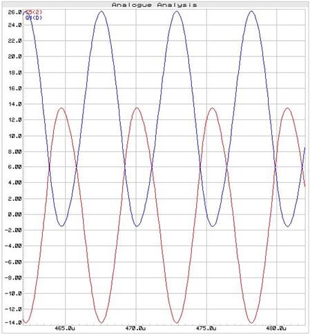

    Some quite interesting, perhaps even astounding "discoveries" may be in progress at TW on this thread:
    http://www.thereminworld.com/Forums/T/28789/theremin-circuits-scratchpad?Page=0

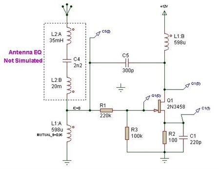

    Latest simulation circuit for FET "clone" of RCA Armstrong oscillator. Note C5 now couples D-G which is the same as what occurs on the RCA.. Inductor values are now based on calculation using winding and form data.. All detailed at TW.
