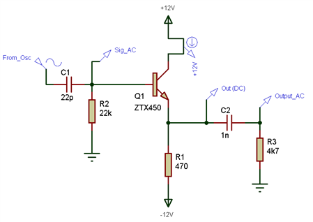

Basic emitter follower:

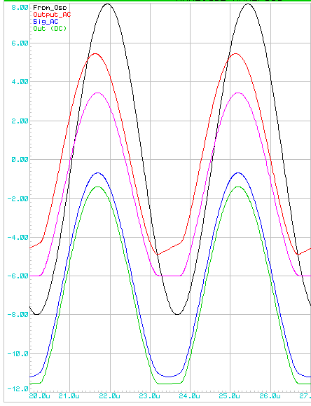

The above is fine if one can tolerate the high quescent current and fairly low imput impedence .. But increasing R2 to 100k gives the following heavily distorted and unusable output:

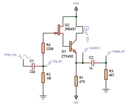

We need to increase  the input impedence - This was my solution (as yet not physically tested) - A Jfet "driver" for the NPN.

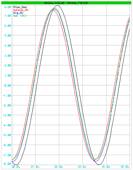

And the waveforms:
The input Z can be extremely high - R2 can be 10M with no problem.
Below is shown a slightly modified buffer - R2 is 1M and a 220k resistor R4 is in series with the gate - This reduces the gates capacitive effect on the oscillator, and (together with this capacitance) acts to roll-off frequencies above about 3MHz (-3db @ 3MHz)
