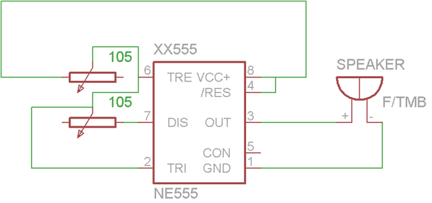

Second question: I need to make a circuit which outputs high-pitched blips (or continuous pulse) using 555 timer. I had this circuit diagram but I lost it.

    You can find all this type of stuff here:
    1 - 200 Transistor Circuits
    and
    101 - 200 Transistor Circuits
    and
    50 - 555 Circuits
    and
    100 IC Circuits
    Hit Ctrl-F and type a keyword or two, and you're bound to come up with these circuits, or ones you can adapt to your needs.
