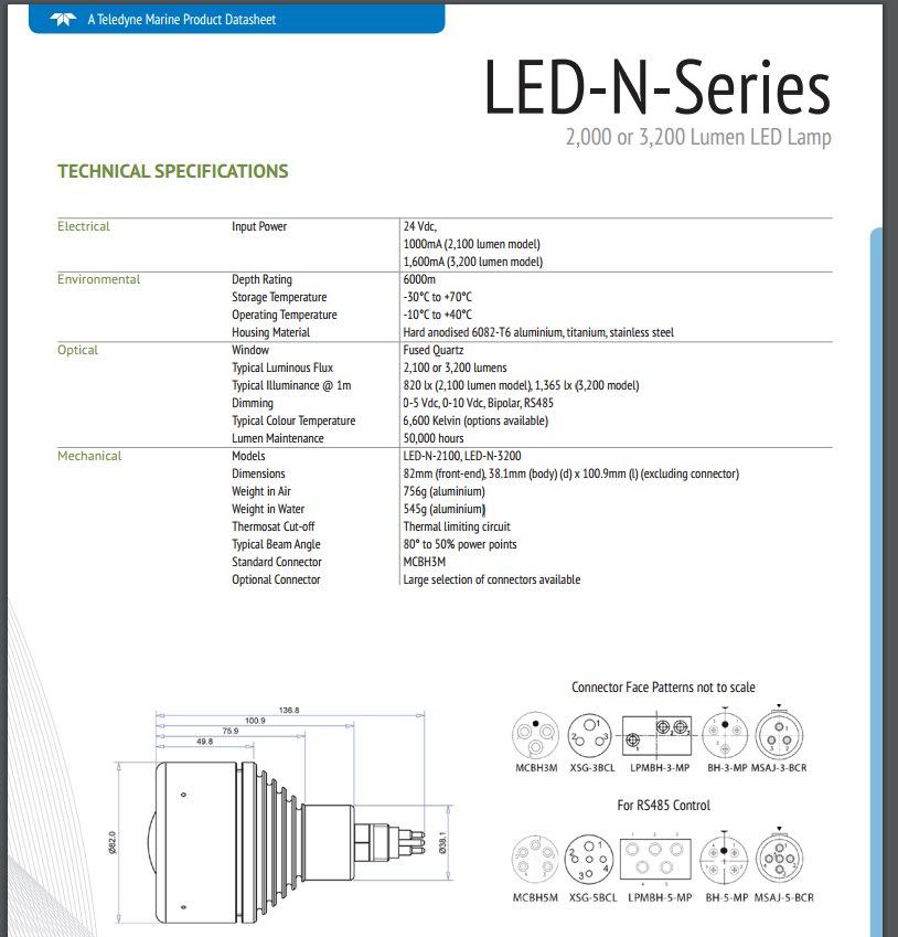

I am trying to figure out how a bowtech subsea LED light is able to be dimmed. I have had hands on experience with home projects that I have dimmed my LED lights using pulse wave modulation so I understand the very basics of dimming an LED.
The manual for the subsea unit only gives  the following information information: "The dimming control signal is similar to that of a camera in that the longer +12v is held on the pin the brighter the lamp becomes and the the longer you hold -12v on the pin the dimmer the lamp becomes".
I presume there is something in the light unit its self, that changes the negative or positive input control voltage into, I guess, a pulse modulated signal that dimms the light? I just think I am missing something and I presume it has to do with tri-state (control) logic that I do not understand very well. I am a hydraulics technician so I apologise for any wrong use of terminology!

    It posible that the datasheet shows all the possible dimming option of the series, but that a single product has just one (I think that Connector face patterns pictures confirms the idea).
    Bruce, please confirm us that yours is a 3-pin pattern, then probably the AN-10, stands for analog 0..10V.
    By other hand I am still missing the pin-out... image, which ones are positive supply, negative supply and dimming.

    Pretty sure this may be what your looking for  http://www.bowtech.co.uk/iadmin/Uploads/productDocs/80/LED-N-Series.pdf
    Clearly shows a few dimming options, none of which is -12 to +12

    The Lights are 24V 1.6A LED-1600-I8-AN-10 from Bowtech. I currently do not have access to there data sheet.
