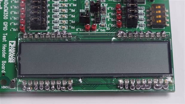

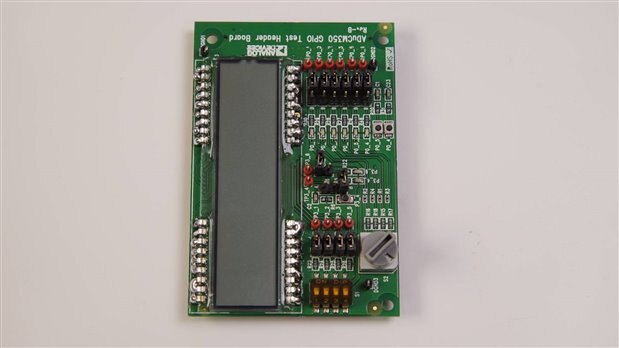

Are you an ace electronics troubleshooter? Do you think you can catch a problem that someone else either didn't notice or couldn't find? Well, here is your opportunity to show your stuff and tell the world where someone else messed up. So, give us your best analysis of what’s wrong with this PCB?

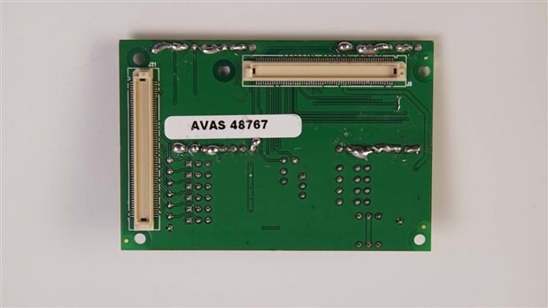

    The design is not ok, the mounting pcb holes are under the LCD.
    The question was "what's wrong with the PCB" and not "what's wrong with the soldering"

    The obvious problem is the soldering. Big globs of solder connecting multiple pins. This probably happened because the person used the wrong temperature on the soldering iron (probably too hot) and too much solder. However if you look closely you notice there are a couple of jumpers that are connected to only one pin.

    Was this built by a civil engineer? because there are bridges everywhere!!!

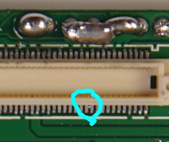

    I think I can see the problem, looks like there's a solder bridge here image:-
