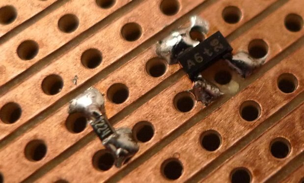

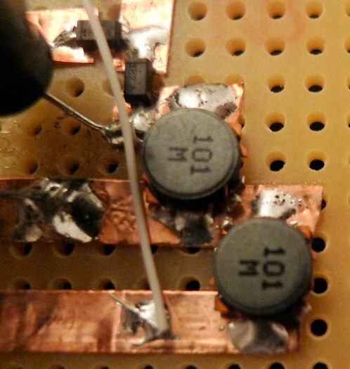

I know there are adaptors for a variety of surface mount components to help use them with through-hole boards etc.  This diode package is a little unusual though - e.g:
https://www.onsemi.com/pub/Collateral/MBRS340T3-D.PDF
(data sheet for a Schottky Diode)
I don't have a specific PCB layout to use it on so scratching my head for alternative approaches.  I'm assuming that part of the function of the soldering pads is to act as a heatsink but I'm guessing at that if I'm honest!  Does anyone have any suggestions?
Thanks
Andrew

    Regarding the diode land pattern/footprint, as Frank says, there will be a recommendation in the datasheet, so that can be a start. For nearly all SMD parts, I find the default recommendation to be acceptable for hand-soldering too, even though the datasheet land pattern is normally for an automated process (e.g. reflow or wave). As Frank says, optionally you could increase the size of the pad outward, to make it a bit easier if the pads don't already extend much beyond the component physical dimensions in the datasheet. Sometimes I may extend by 0.3mm or so, for certain components which have an overhang (e.g. large surface mount inductors with an outer ferrite shield that goes beyond the land pattern). For that diode package, that isn't the case, so the datasheet land pattern should be fine.
    I'm not sure why there are holes in the land pattern, I'm wondering if they are for optionally soldering a through-hole diode instead, i.e. the land pattern is dual-purpose maybe.
    Normally holes in pads are not used unless they are filled (i.e. commercial PCBs) since solder will drip through otherwise, but for home prototyping sometimes they are necessary (in which case I'll try to use the smallest hole possible). For a SMD diode breakout board, the holes shouldn't be needed in the pad I think, unless I'm missing something.
