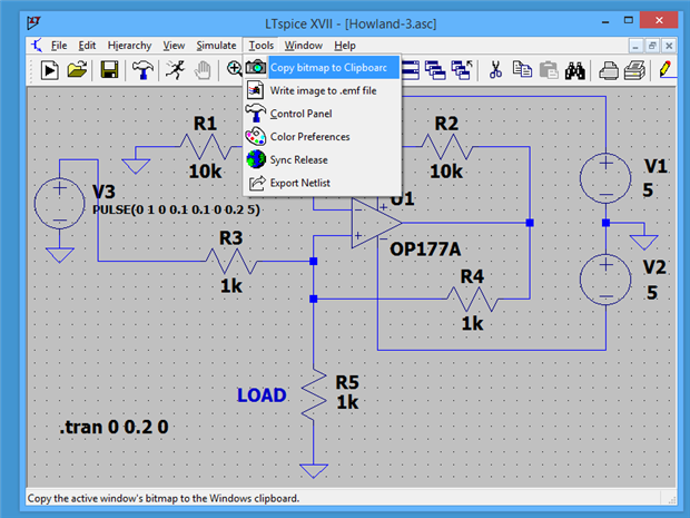

  • jc2048
    0 jc2048 over 6 years ago in reply to Andrew J
    In case you don't know, you can save a schematic via the clipboard like this. It isn't very obvious the first time you use LTSpice. I then read it into GIMP and export it as a .png file, though you'll probably have your own favourite way of doing that bit. You'll probably get more of a conversation going if there are embedded pictures to look at in your discussion posts rather than links to files on other websites.
    With regard to the design files, people seem to be able to attach .zip files to blog posts, so maybe try that.
