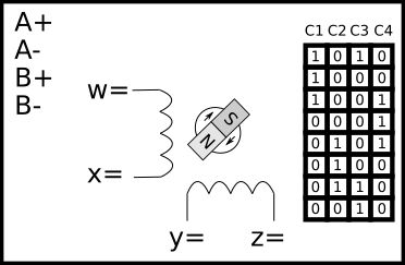

Assign the labels (A+, A-, B+, B- ) to the pins (w,x,y,z) on the motor windings and to the columns (C1, C2, C3, C4) of the table, that will enable the shaft to rotate in the clockwise direction. The sequence that the voltage is applied to the motor pins is shown in the table.
Your answer should be in the form w=A+...z=B-  & C1=A+….C4=B-. No these examples are not the start of the answer.
I suspect I have incorrect manufacture documentation. The documentation indicates the step sequence for the stepper motor will rotate the shaft clockwise. The stepper motor does rotate in a clockwise direction with the sequence provided but stepper motor theory would suggest otherwise.
I have exhausted my stepper motor knowledge to make sense of the vendor drawings. If I use the motor pinout and winding diagram from the documentation with my understanding of motors the shaft should rotate anticlockwise with the sequence provided. I have used my theory knowledge to test against other vendors motors and it appears correct. When I make one pinout change on the vendors drawing the sequence and the rotation match motor theory.
I have a personally that can't ignore such a conflict. WHO CARES IT WORKS! I wish at times, I was one of those people. I have worked this problem off and on for a few days and can’t seem to resolve the conflict. My solution, create a discussion quiz and see what the E14 Community members can provide. I'm hoping your answers will match my understanding:)

    dougw over 5 years ago +1
    Is it possible they are looking at the motor from the opposite direction that you are?

    I'm going to award you the correct answer button DW. Your message triggered something in my thoughts.
    A few hours after reading your post, I was sitting in the reading room and recalled this picture. If the output pins 1B, 1A, 2A & 2B are connected to the four pins of the motor in the sequence they appear, the motor pinout is correct. I assumed the Asian knock-off board had reversed 1A & 1B to avoid copyrights. I connected the pins in the sequence 1A, 1B, 2A & 2B. I made the reversal that created the problem.
    My spouse is sitting across from me on the couch asking, why do I do this to myself. I should just let it go. Oh well, got the answer I desiredimage The theory from the electronics course I took 50 years ago is still valid today. At least the motor operation theory is.
