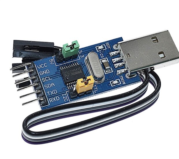

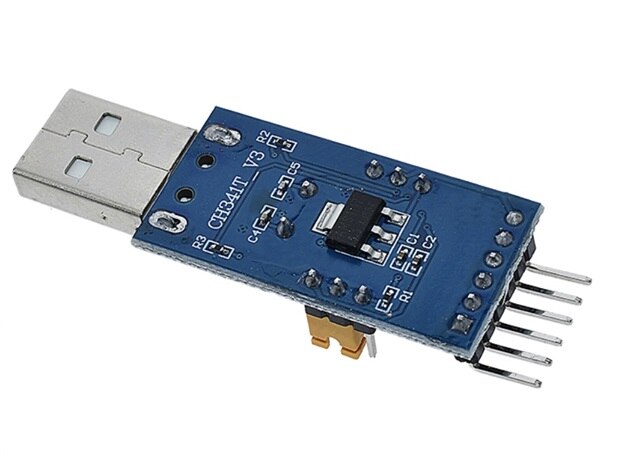

Hi guys,
I have just purchased a USB to IIC adapter (see pictures below) I went random alibaba thing as it was the only one I could find with 5v/3.3v jumpers plus specified works on Mac.
Link: https://www.alibaba.com/product-detail/CH341T-2-in-1-module-3_1600073269744.html
I contacted the company and they forwarded me to https://pan.baidu.com/s/1R66X8r47V-ITolVK1-LHVw for the driver. Alas I have not got and am unable to figure out the Baidu website. Lack of translation and it keeps failing to allow me to register a foreign number strongly seems to be hampering my efforts to obtain (anyone have a Baidu account that can help me here too would be great) the file.
Looking at the Chipset CH341T I have managed to find CH341SER_MAC.ZIP - Jiangsu Qinheng Co., Ltd. which seems to install drivers for it.
*edit* I have tried a couple of times to install following the instructions and it doesn't seem to add the required driver in /dev folder
So, I'm hoping I haven't wasted my few $$ on it and someone out there has the same desire to work on their PC (Mac) vs Pi and am able to help; as for the life of me I can't get it to work. It is detected by system information correctly and passes power through (have a basic LED which lights up when plugged into the connectors).
I guess the question is, has anyone had any luck in working with IIC/GPIO on Mac, and if so, how to actually do so? I have installed a bunch of recommended libraries but alas nothing seems to get IIC going.
Thanks

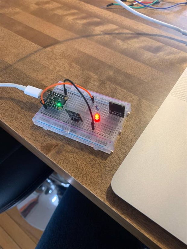

    Looks like we've got it working! I've just started playing with it but seem to be having issues getting IIC to work. That shall be for another question if I don't figure it out on my own. While the original one I purchased seems to be garbage and the supplier is as useful as a 1 legged donkey I'll mark this as answered.
    Thanks again for the suggestion!

    Hi David,
    I've used the the MCP2221 breakout from Adafruit that I posted Testing Sensors using the MCP2221A and Jupyter Notebooks .
    I think this would do what you want and is inexpensive and well supported.  I used it on my Windows PC but it has MAC and Linux drivers. It defaults to 3.3V and you need to cut a trace and jumper pads to change to 5V.
    I just remembered that it has a USB-C connector, but that was a plus for me as I prefer it.
