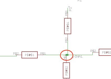

I'm new fairly new to Eagle software. I've already figured out how to make custom parts and add them to the schematic. I'm currently trying to route all the wires, but only some of the wires are getting connected. I have no idea why. Here's a screenshot of part of my circuit showing one of the bandpass amplifiers with the net wires done and named.

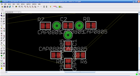

Here's a screenshot of the board showing the same bandpass amplifier with only some of the wires connected with the yellow airwires I think they are called.
I appreciate any help you guys can give me. I'm so frustrated now. I've tried wiring in different ways. I've redone the whole thing several times to no avail.

    0 shabaz over 13 years ago
    Hi Michael,
    It looks like on the schematic, the pins are actually not connected to the green wires, they are just "close" to the green wires.
    You can test by trying to move a component. If the component moves but the wires do not move along with the component, then they are not connected.
    The giveaway would be this:
    It should not be possible to have blobs so close to each other, unless you've modified the grid setting:
    Basically, on the schematic view, you should never change the grid setting from the default (0.1inch). All components are/should be designed such that they can be wired up using the default grid setting.
    You should only need to modify the grid setting on the board view, or when creating parts.
