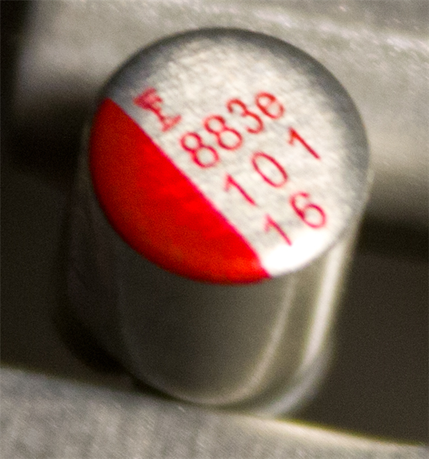

I broke a capacitor off a PC motherboard I was removing, and am having trouble identifying it.  Anyone able to help?
Here's the casing:

    0 e14 Contributor over 12 years ago in reply to johnbeetem
    This puts me on the right track.  Thank you!

    0 johnbeetem over 12 years ago
    That Fujitsu's logo.  101 = 10E1 usually means 100 uF.  16 is probably 16V.  Probably an aluminum electrolytic.  The 883e should identify the particular component family.  For a PC board, you should make sure the replacement cap has the same lifetime as the one it's replacing, since a weak cap isn't going to last long on a hot PC motherboard.
    Here's a Fujistu cap I found at ebay with no effort: 4 Fujitsu re 16V 270uF Aluminum Solid Capacitor | eBay  I have no idea if the families are similar.
