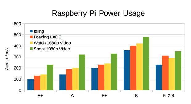

    For more information about power consumption:
    Extract from: http://raspi.tv/2015/raspberry-pi2-power-and-performance-measurement
  • clem57
    0 clem57 over 10 years ago in reply to gadget.iom
    That graph is correct, unless you forget to add any current used by USB devices not powered by external powered hub.
    Thanks Paul
