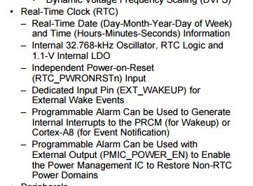

Hi Guys,
I got a BBB rev C. (w debian). I have connected an esternal battery on the right PMIC inputs, I setting the date/hour, but the processors doesn't remember them. I cannot use an external RTC.
Can You help me.
Thanks a lot
Enrico

    0 shabaz over 11 years ago in reply to e14 Contributor
    Hi Enrico,
    The AM335x does have a built-in RTC, but what driver did you use to try to program it and use it? Does the Angstrom or Debian releases support it?
    I don't know anyone who has tried to use it on the BBB.
    Also, I know a LiPo battery can be used with the BBB's PMIC, but I don't know if a Lithium coin cell is supported - I've not checked the schematic.
    I think you'll find an external RTC is way easier, otherwise you'll probably be the one trailblazing here - depends how much time you have.
    0 e14 Contributor over 11 years ago in reply to fvan
    Hi Frederick,
    I want to use the RTC present on AM3358 (see DS http://www.ti.com/lit/ds/symlink/am3358.pdf) processors.
    From the BBB schematic I can see that can use a battery pack, through PMIC, for maintain the RTC in "live" mode....
    I tried it but, after reboot, the system has a bad date/time....
