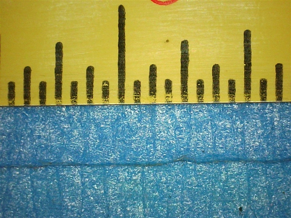

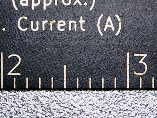

When the microscope was adjusted for a magnification of 50x the resulting field of view had a width of 12 mm across :
That is a little bit smaller than I’d like but it is what it is. I would have like to capture maybe say 50 mm across, but I would also like more image resolution…

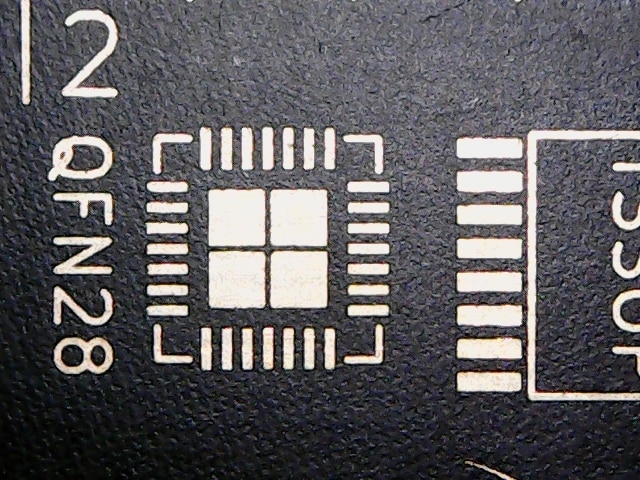

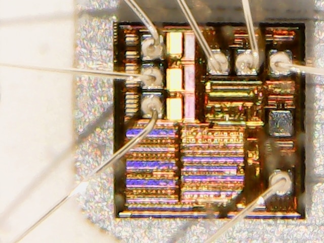

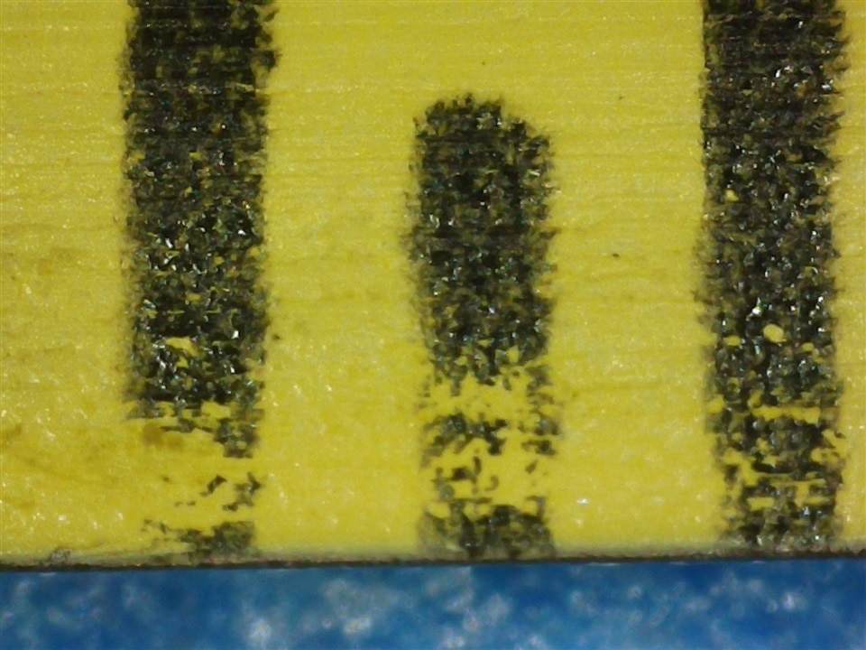

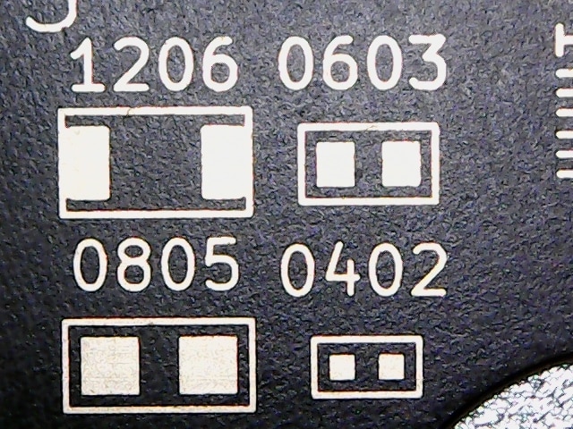

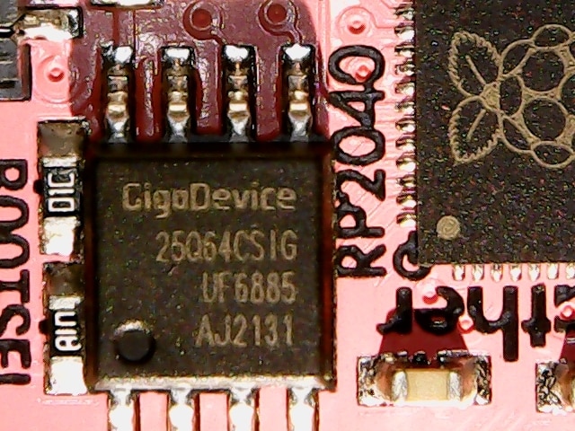

Here are some random photos I took:
At maximum magnification, the lens casts a shadow onto your viewing area. So, you need to provided external lighting in that case.

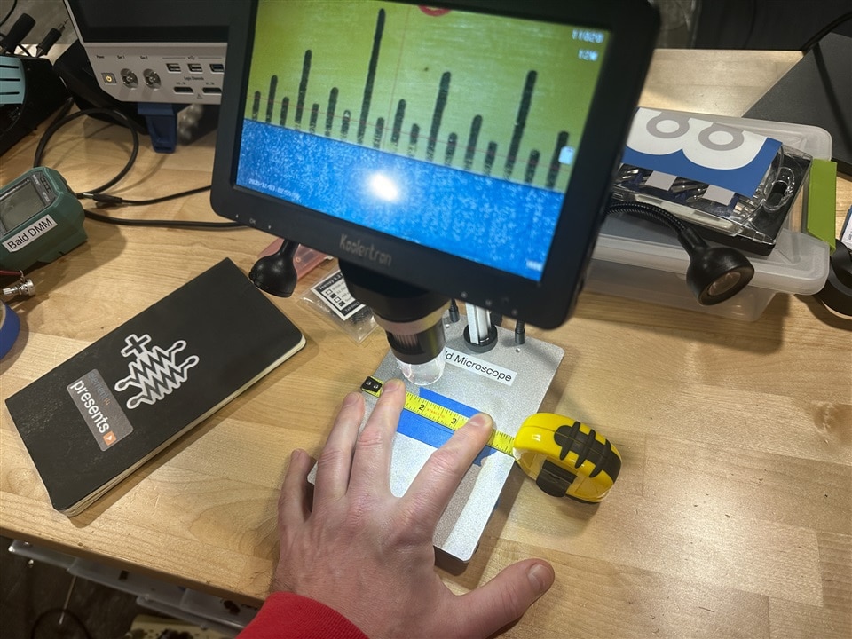

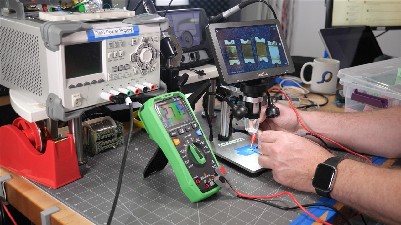

    I have one of these with the LCD screen and (mostly) love it after two years of countless uses.
    I paid about $100 for it on Amazon. It was this 7-inch that claims 12 MP. Although, it is clear there are many other models/brands that are OEMs of one design.
    The LCD's latency is low enough for soldering. The built-in battery makes for a great portable unit too. (Although, I had to refresh its 18650 to get it to hold a charge.) The additional goose neck lights REALLY help improve image quality. (As with all small sensor cameras, the more light you can provide, the lower their ISO, so the lower the noise.)
    Seriously, I cannot impress how important it is to get MOAR LIGHTS pointed at your board! You need 5 not 4 lights, in this case.
    These also have a USB port to connect to a PC. HOWEVER. You cannot use the screen and the PC connection at the same time. Which is a real bummer. Because I enjoy using OBS (or VLC) to open it as a camera on a larger screen. (or, for WBW videos and live streaming, to share the video, like in the low temp solder paste episode.). But, then the LCD is disabled. It becomes awkward to use for soldering--especially with the USB delay. (I have started to get used to it though.)

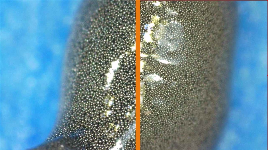

    BUT! It is FANTASTIC for inspection, especially as a standalone battery-powered unit. Whether you are checking solder joints or reading marks on an IC or looking at the balls inside of solder paste. :)
    t5 vs t3 solder balls in solder paste
    Basically, when connected to a PC, it becomes the same one scottiebabe is using except with a big awkward rectangle on top!
    Regardless, I also recommend any of these USB microscopes (with sufficiently good sensor!)
    This $100 was the best I have spent on a test tool in years.

    I see 3 fancy items in that photo:
    -coffee cup with blue tape
    -sweet digital microscope
    -multimeter measuring 2.7V in diode mode!
    I'm torn which of the 3 is the fanciest!
    Thanks as always for your expert advice, the videos you shot with that 100 microscope look sooo good!
    May I ask what the field of view is at the lowest magnification? no rush though.
    As you say, I think for the price these display included microscopes are hard to beat. I want one! LOL
