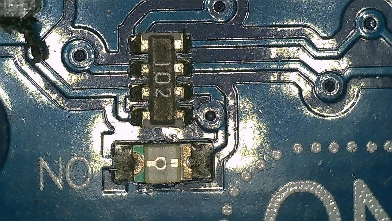

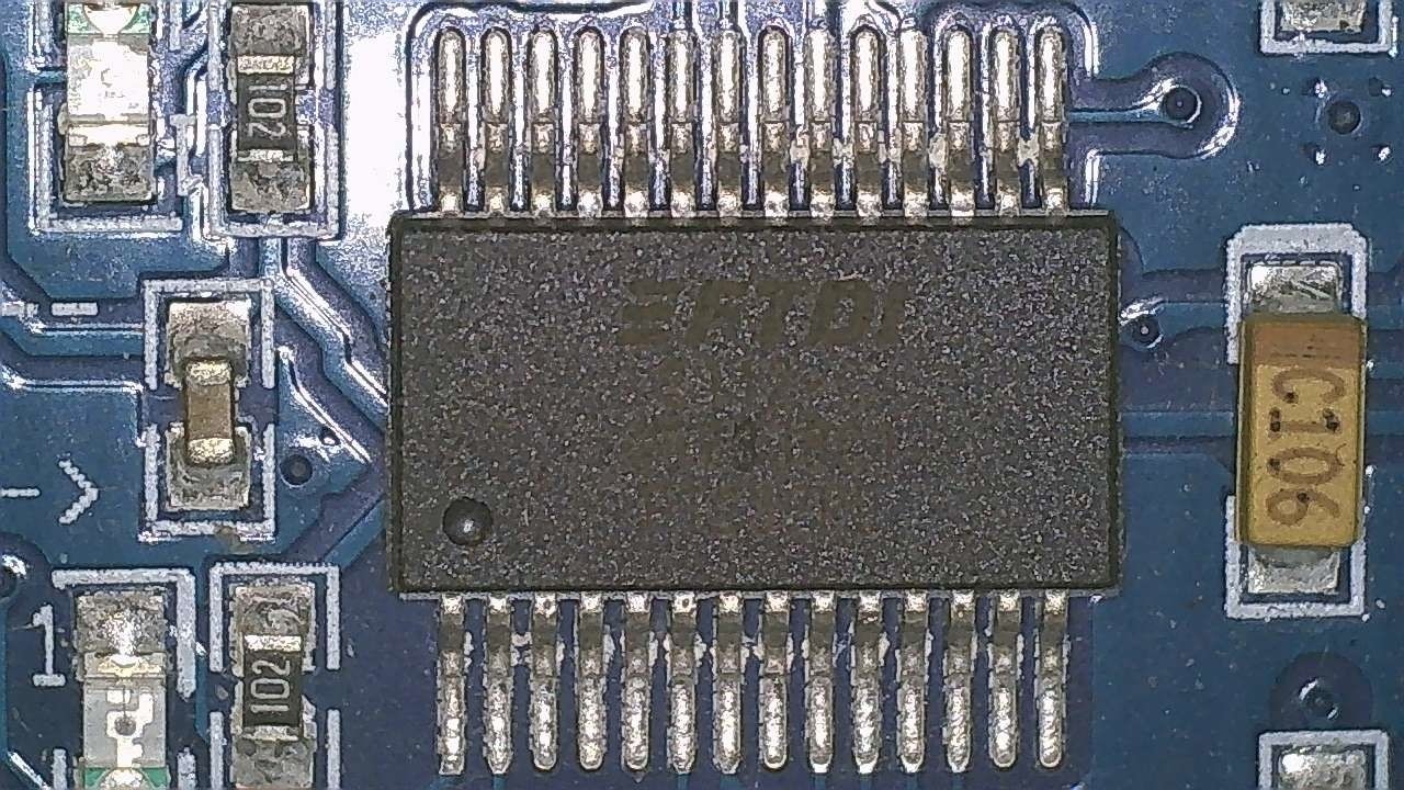

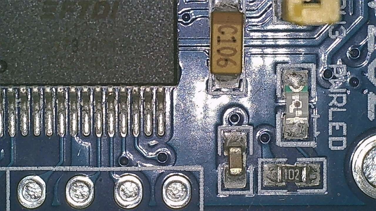

Here are some random photos I took:
At maximum magnification, the lens casts a shadow onto your viewing area. So, you need to provided external lighting in that case.

    Surprisingly good images! I wonder if you were lucky, and got a unit that is well-assembled with the lenses. Very neat that you have the adjustable zoom too.

    The magnification looks pretty good.  I will be on the lookout for one of the models that includes the display.
