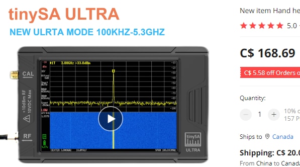

  • scottiebabe
    scottiebabe over 3 years ago in reply to shabaz
    I'd love for a Tiny SA ultra to find its way into my Christmas stocking LOL
    https://tinysa.org/wiki/pmwiki.php?n=TinySA4.Specification

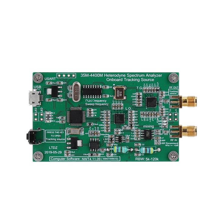

    shabaz over 3 years ago in reply to weiwei2
    Hi Weiwei,
    Nice find. I think that would work very well. The frequency range is limited, but in that range I think it would be awesome. I've wanted to build one using the AD chip for ages, but other things get in the way. Something ready-made like that sounds really neat.
