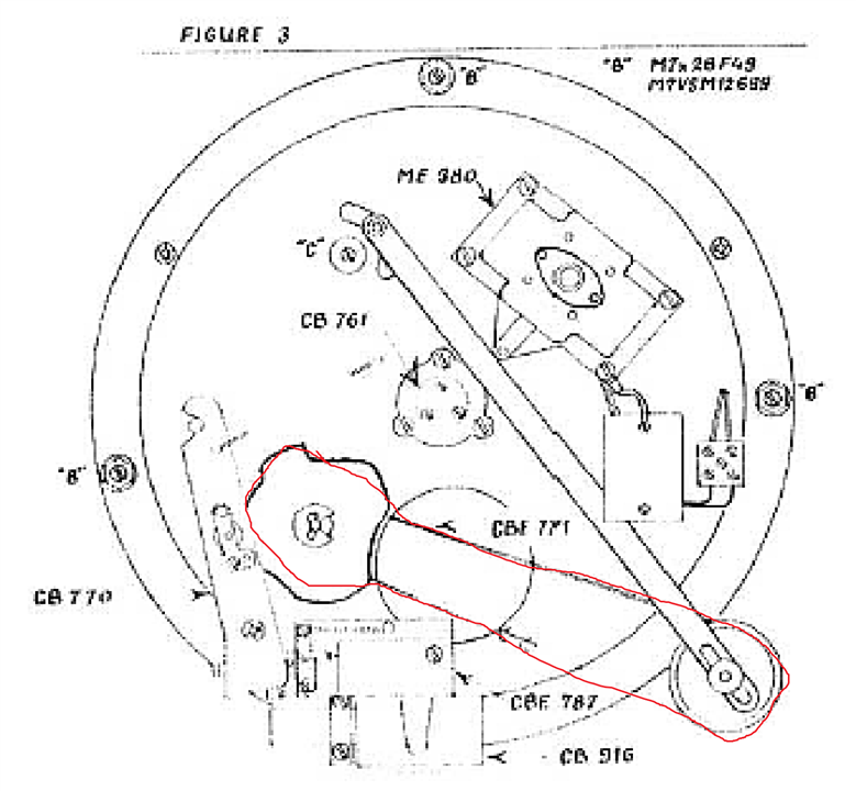

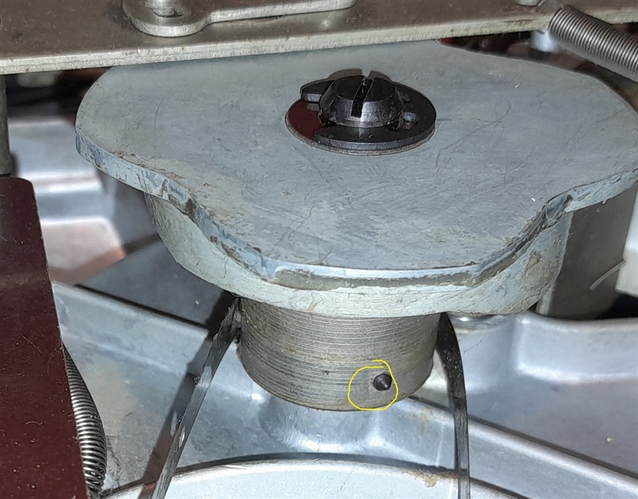

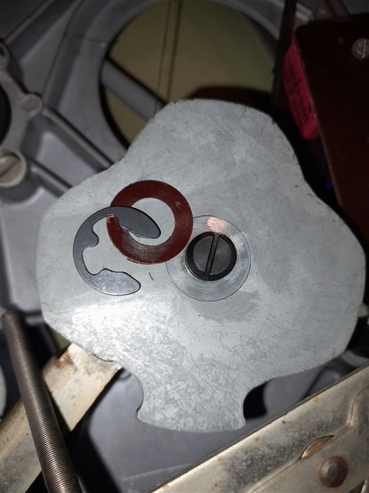

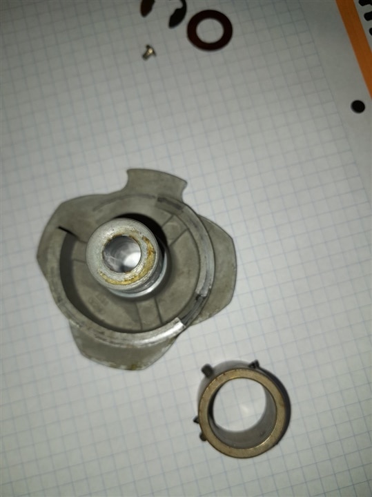

I have a turntable from the mid-60, Thorens TD 124. It has a mechanical issue: the speed selector has a worn-out component.
This holiday I'll see if I can fix this. These tables, and the components, go for crazy prices (check ebay for anything related to a TD 124, it's a strange world out there).
The worn component is part of this contraption:

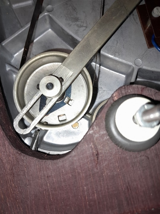

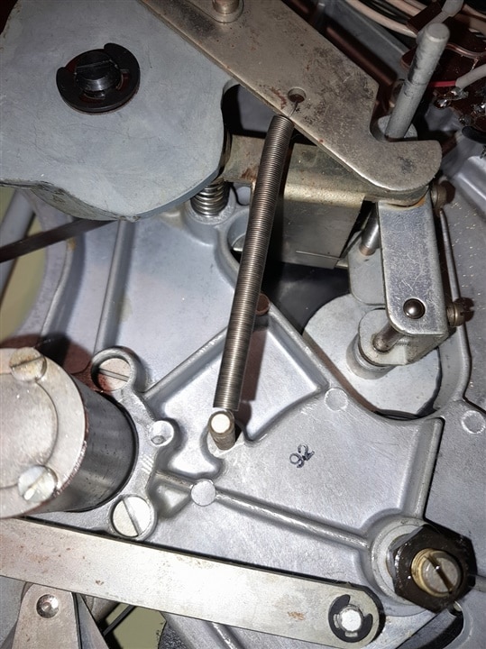

    Jan Cumps over 3 years ago in reply to Jan Cumps
    Jan Cumps said:
    I lost the photos of how it looked like when I bought it.
    correction - I found low res photos back on google photos:
    Jan Cumps said:
    I also lost videos and photos from when I took apart the motor and the complete tonearm.
    I could not find any back of the motor teardown, but I found the ones from the tonearm back
    Jan Cumps over 3 years ago in reply to colporteur
    Grinning it was clean, just gathered dust from being stored away for about 3 years.
    I lost the photos of how it looked like when I bought it. It was sitting inside a tent in a yard sale, on a table in a puddle of water.
    Still surprised to this day that I managed to get that tonearm (and it's plethora of ball-bearings) back together. Cheapest replacement I can find online (with issues) is above 400€.

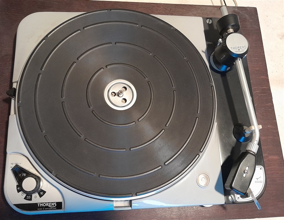

    Worky:

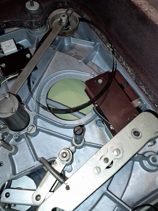

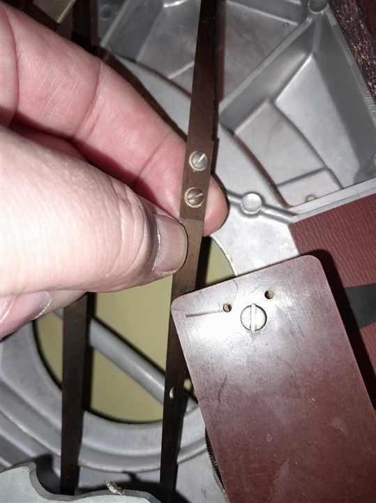

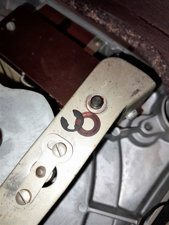

    Checking the player while it's standing up. Washers and circlips are replaced.
    Test to see if the idler wheel engages at the right height of the tapered axle:
    And a test with the platter on:
