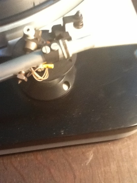

I have a turntable from the mid-60, Thorens TD 124. It has a mechanical issue: the speed selector has a worn-out component.
This holiday I'll see if I can fix this. These tables, and the components, go for crazy prices (check ebay for anything related to a TD 124, it's a strange world out there).
The worn component is part of this contraption:
    Jan Cumps over 3 years ago +6
    Worky: https://youtu.be/8tMOoV7XueE
    Jan Cumps over 3 years ago +3
    It turns out that I'm lucky. The part isn't worn, but lost grip. Symptom: the outer ring should turn the speed switcher, when it's turned by the plate steel belt. But it slips. Cause: the speed switcher…

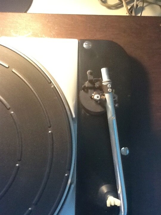

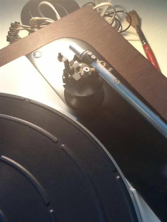

    I lost the photos of how it looked like when I bought it.
    correction - I found low res photos back on google photos:

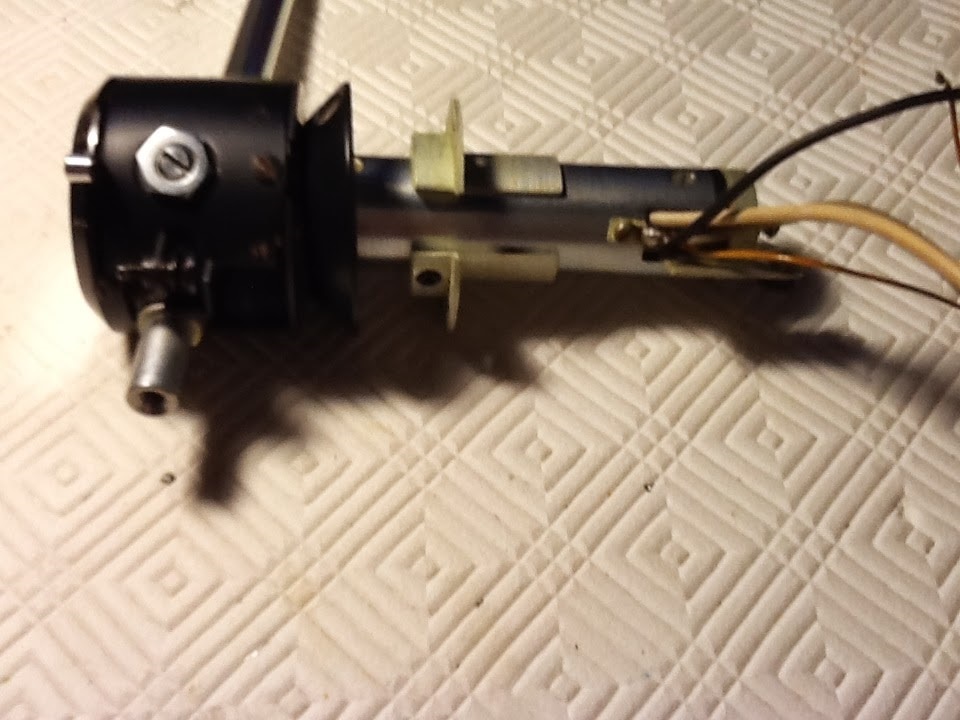

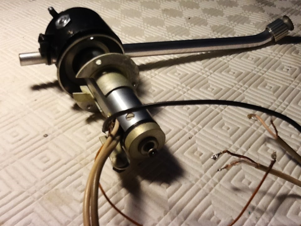

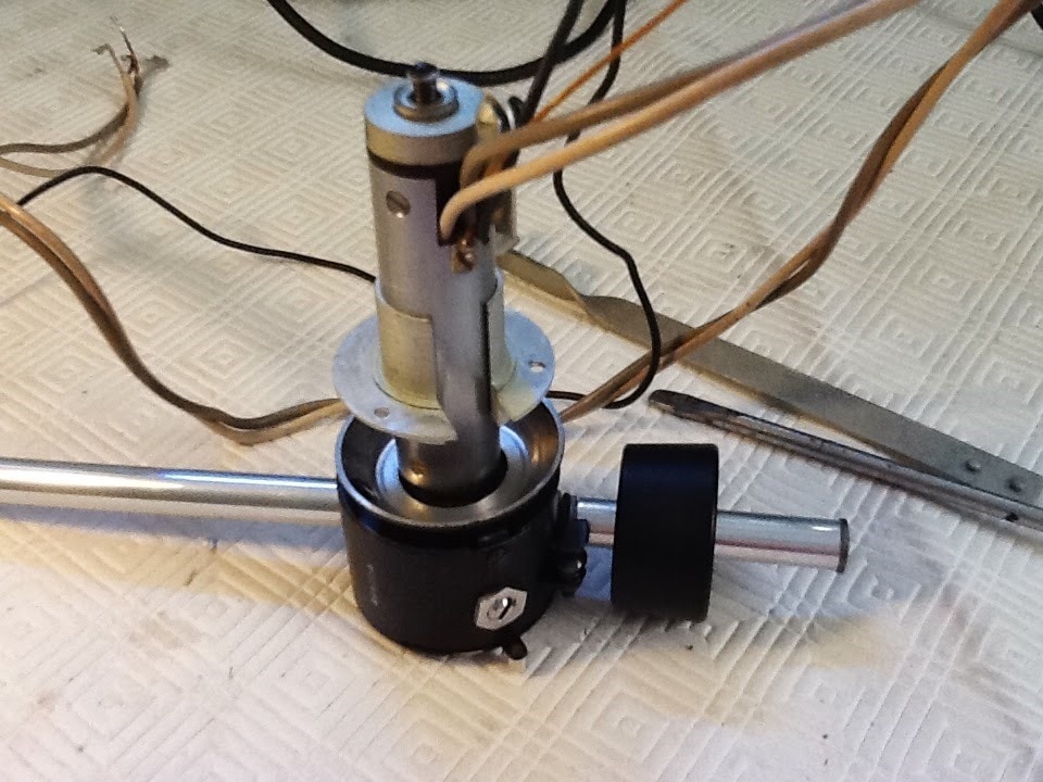

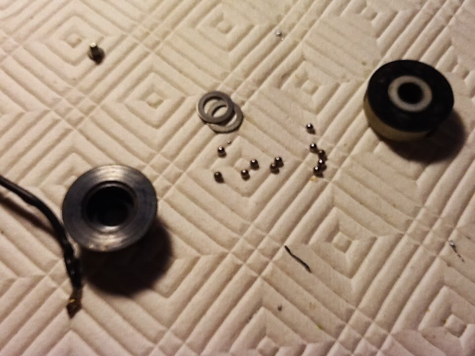

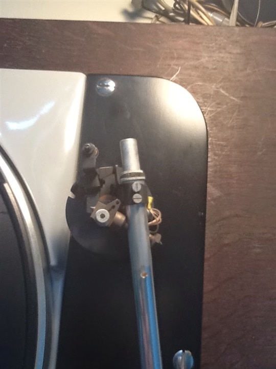

    I also lost videos and photos from when I took apart the motor and the complete tonearm.
    I could not find any back of the motor teardown, but I found the ones from the tonearm back
