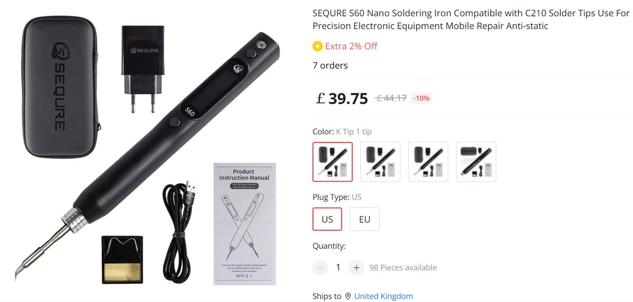

    This one, Sequre S60, accepts JBC C210 series tips, which cover a range of surface-mount and through-hole prototyping, but are no good for large connectors:

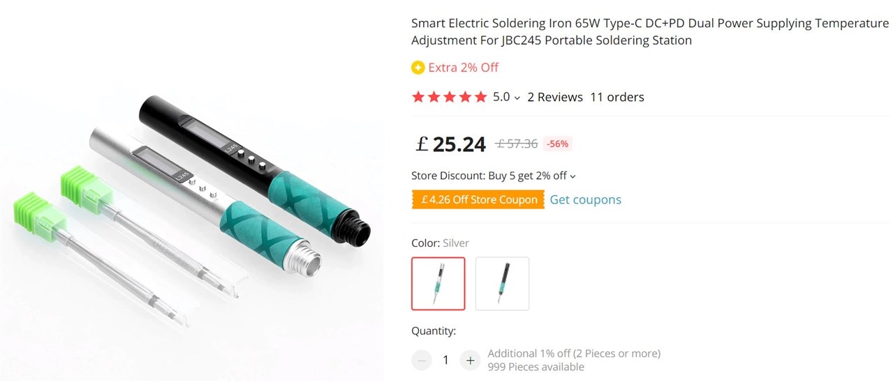

    I also ordered this "Smart Electric Soldering Iron" which looks very basic, it is pretty cheap. I don't expect it to be amazing at this price, but I was still curious if it could function as a basic soldering iron. This one is compatible with C245 series tips, which are fine for large connectors, as well as surface-mount.
    A benefit for these two models though, is that because I already have C210 and C245 tips and know what they solder like, it could be interesting to compare.
