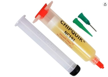

    No flux?
    In my 'go to' kit I always need a telescopic magnet .
  • scottiebabe
    scottiebabe over 3 years ago in reply to cstanton
    Flux is a definite yes! I just don't know how to store it yet aside from take entire tube
    Perhaps squeeze some into some ultra tiny plastic tin...
    Great pick, and it could serve as an antenna if needed.
    Thanks:) Both added!
  • baldengineer
    baldengineer over 3 years ago in reply to scottiebabe
    I have a flux pen in my kit.
    Even though they aren't my favorite flux applicator anymore, their compact size and locking cap make them ideal for travel.
