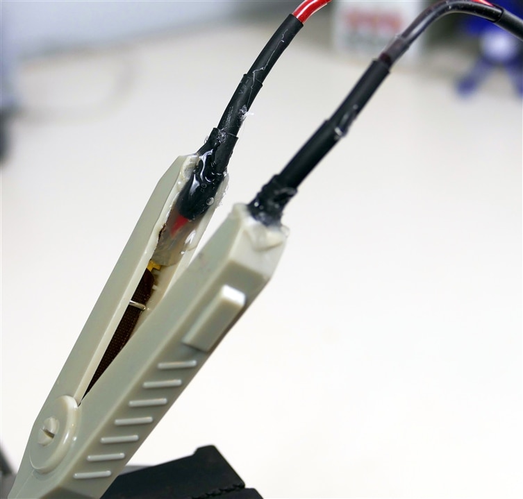

    dougw over 3 years ago in reply to scottiebabe
    I recently used hot glue to fashion a strain relief (along with heatshrink) when connecting wire to a Kelvin clip - the wire needed to be immobilized to prevent stress on the solder joint:
    Sometimes it is hard to beat the hot glue solution.

    beacon_dave over 3 years ago in reply to dougw
    dougw said:
    How would you tackle this build?
    • sleeved grommets in the end of the clip handles
    • test lead sockets in the end of the clip handles
    • cable tie through the plastic, around the cable, and back through the plastic
    Perhaps a little less glue Slight smile

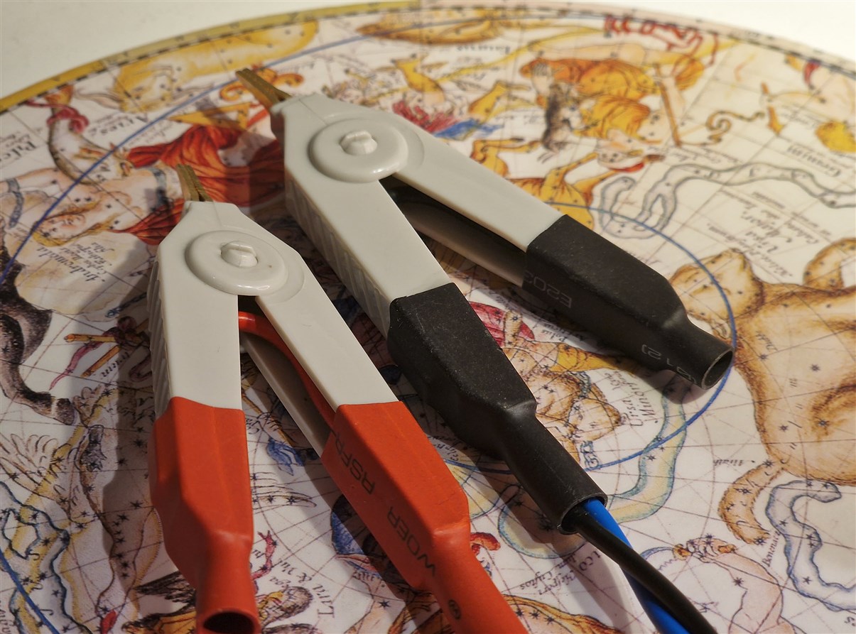

    shabaz over 3 years ago in reply to dougw
    I've got test leads that have similar clips, they implemented the wiring slightly differently, coming out one end of each clip (i.e. looping one wire in a U-shape to reach the other side from inside).
    Photo on my fancy mouse pad :
    I don't think they did anything apart from soldering them and then a bit of heatshrink, but I've not cut them apart to see what they did, because I use these clips. I think they just expect it to last a while, long enough for the wear-and-tear to not be significant perhaps.

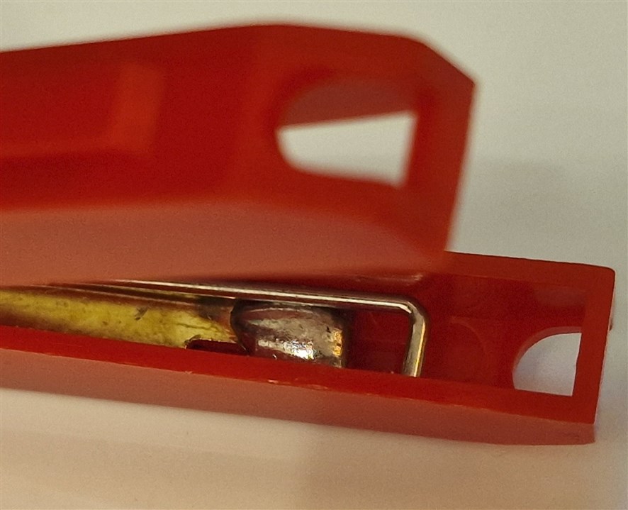

    Here's a photo of the inside of an unused one (same type) (to anyone who is not familiar with these, the copper part is the terminal with some solder already on it, and the other metal piece is just part of the spring that holds the clips closed).
    I don't know if it would work, but maybe pack the cable with a bit of sleeving, and then as Dave says use a cable tie (could make a couple of notches on the inside for that). The head of a small cable tie could then be on the inside, and it wouldn't interfere with the other side, because the two cables would egress from the one side. This cunning plan may or may not work : )
