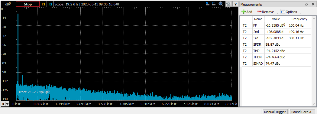

    That's great to see the 3rd harmonic way own into the noise floor!

    Playing a wav file with a 100 Hz tone :
    Looks reasonable enough.
