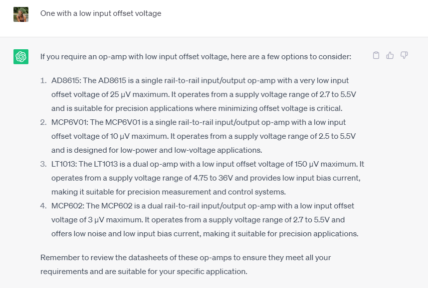

  • scottiebabe
    scottiebabe over 2 years ago
    MCP602 datasheet:
    Also not rail-to-rail input... Maybe one day!
  • scottiebabe
    scottiebabe over 2 years ago in reply to scottiebabe
    But so interesting that it seems to know what jargon design engineers are looking for... Perhaps it thought the drift/tempCo of input offset was offset over temperature. Its learning things!
  • scottiebabe
    The TLV3691 is a comparator not an op-amp, supply voltage 0.9 to 6.5 V and has a quiescent current of 75 nA.
