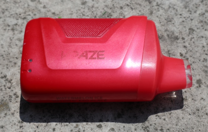

While cutting the grass I found this USB-C widget laying out by the curb. The nerve of some people to toss their e-waste on the side of the road!
hmm... I know nothing about these kind of widgets...

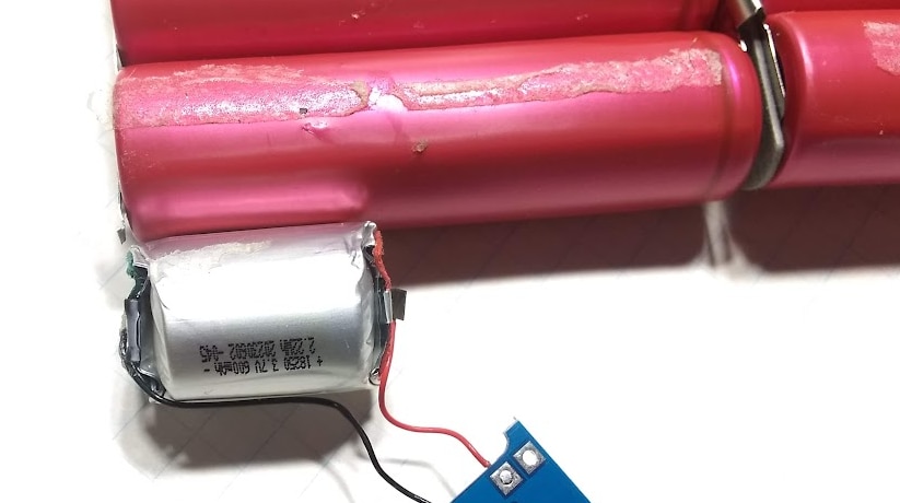

Inside there is a 600 mAh li-ion battery
Beyond the battery and maybe the USB-C connector, i'm not sure what else is worth keeping.

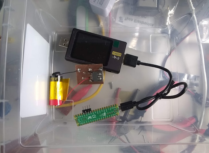

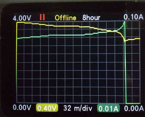

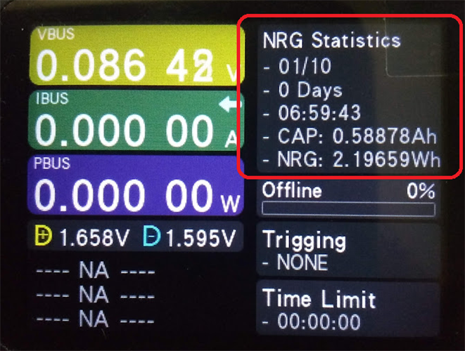

I haven't tested the battery yet, but I have just the USB widget for that task!
  • scottiebabe
    scottiebabe over 3 years ago in reply to baldengineer

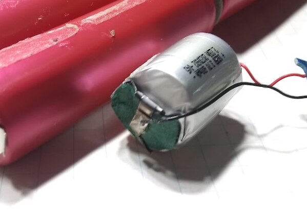

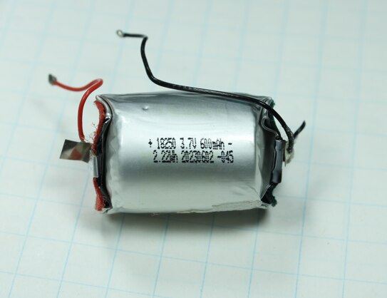

    lol bloated... So far so good, it is an 18250 cell, which does look kind of strange
    Fingers crossed it doesn't turn into a spicy pillow..
  • baldengineer
    baldengineer over 3 years ago in reply to scottiebabe
    Is that cell chubby or bloated?

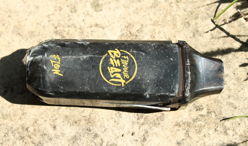

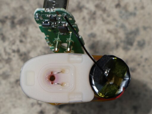

    Hurray! More smelly junk Slight smile
    This one was in pretty rough shape...

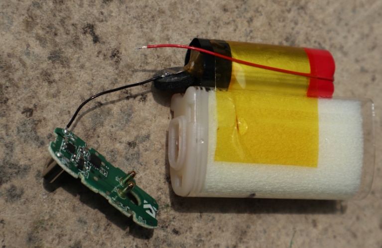

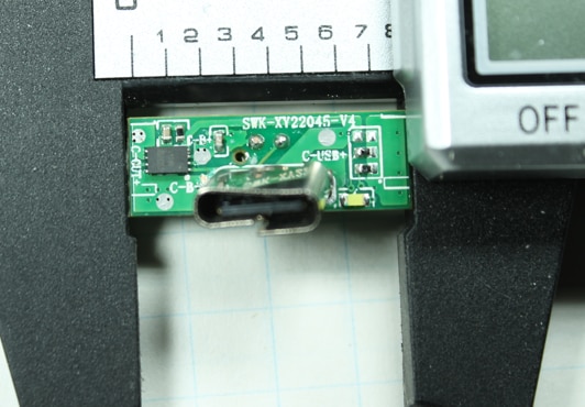

    Inside is just a tiny little PCB with a single 2x3 mm DFN

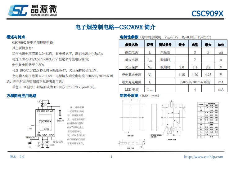

    The all-in-one IC is actually pretty neat, its a CSC909
    http://www.cschip.com/upload/cn/propdf/CSC909X.pdf
    The battery is a 600 mAh li-on chubby cell,

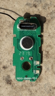

    scottiebabe over 3 years ago in reply to scottiebabe
    It appears they attempted to make a multi-use footprint...
    Hopefully, the bottom USB-C shell is plastic near the microB mounting pads.
  • Fred27
    Fred27 over 3 years ago in reply to scottiebabe
    SMD resistors don't grow on trees. If they're making millions of those he's probably saved the company a few cents.
  • scottiebabe
    And no 5k1 pulldowns on the cc pins, great... *eye roll*

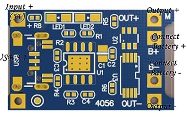

    Slowly, I'm saving the planet! Checkout the PCB footprint on this TP4056 module I bought, designer is a pro!
    Replaced Rprog with a 2k2 resistor for a charge current of 546 mA.

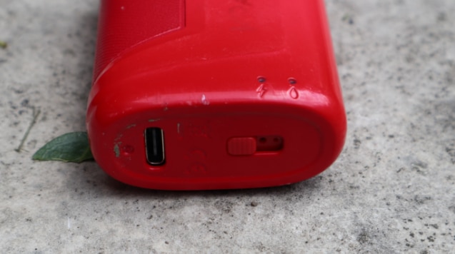

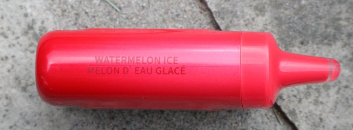

    Well, well, aren't I just lady luck when it comes to finding old smelly junk!
    Fingers crossed for another working li-ion cell Fingers crossed
