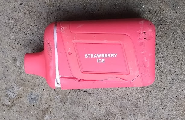

While cutting the grass I found this USB-C widget laying out by the curb. The nerve of some people to toss their e-waste on the side of the road!
hmm... I know nothing about these kind of widgets...
Inside there is a 600 mAh li-ion battery
Beyond the battery and maybe the USB-C connector, i'm not sure what else is worth keeping.
I haven't tested the battery yet, but I have just the USB widget for that task!

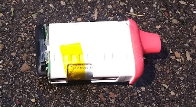

    So what did I end up with, well: a) An interesting story b) An interesting sensory experience from the smell c) A genuine ~600 mAh li-ion cell Perhaps I'll use the pcb as a usb-c power source…
  • scottiebabe
    scottiebabe over 2 years ago +5
    The battery inside claims to have a capacity of 2.41 Wh In a 16350 form factor It doesn't appear there is any dedicated battery protection circuitry. The widget is solely relying on the charger…

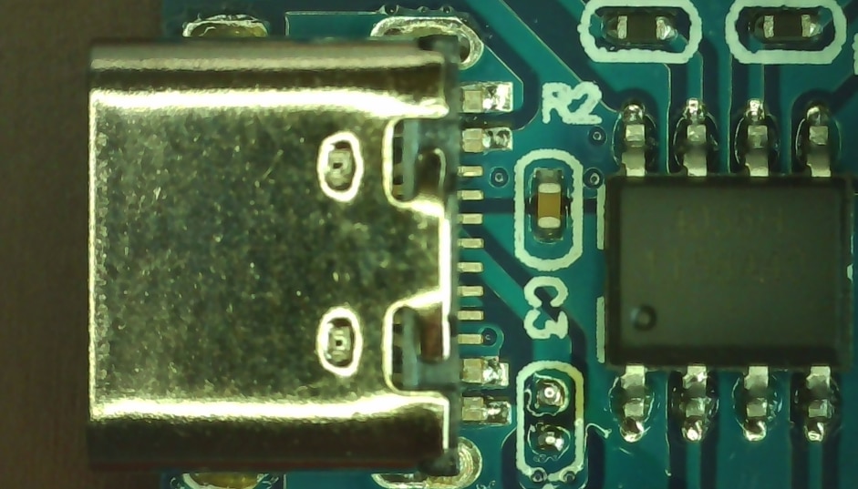

    Slowly, I'm saving the planet! Checkout the PCB footprint on this TP4056 module I bought, designer is a pro!
    Replaced Rprog with a 2k2 resistor for a charge current of 546 mA.
  • scottiebabe
    scottiebabe over 2 years ago in reply to scottiebabe
    And no 5k1 pulldowns on the cc pins, great... *eye roll*
