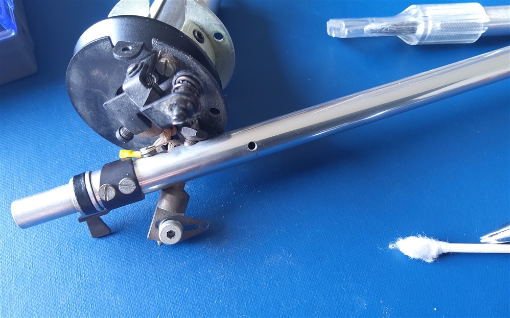

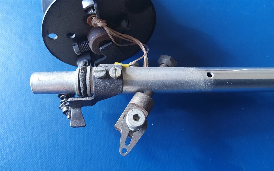

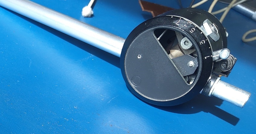

While some say that having vintage audio is like a holy grail - in reality it means work Grinning. This time I'm maintaining the bearings of my table's tonearm. The arm and its moving parts are the most finicky part of the table. And they show their age. Based on the serial number, the table is from 1965 (one of the first 100 Thorens TD-124 MK II). The tone arm is original.
To start, some photos of the disassembly of the arm board.

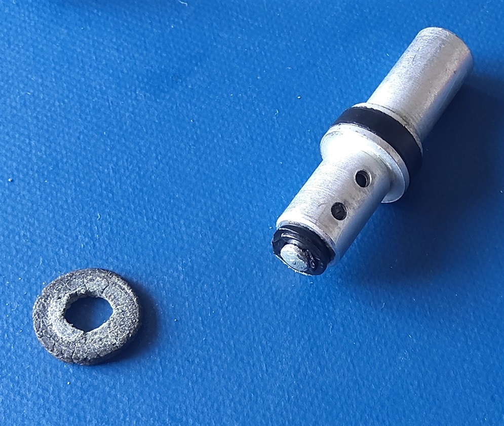

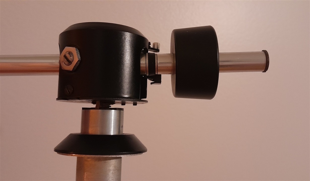

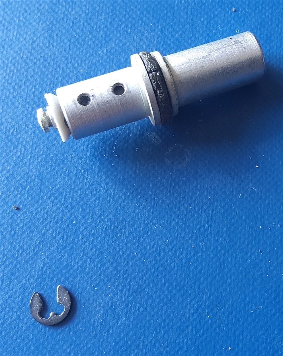

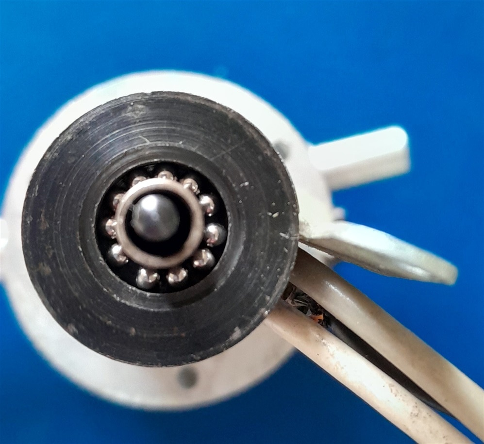

    At this moment, all difficult jobs have been done. I replaced the race and completed the assembly. The arm is now ready to be mounted on the table.

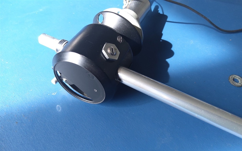

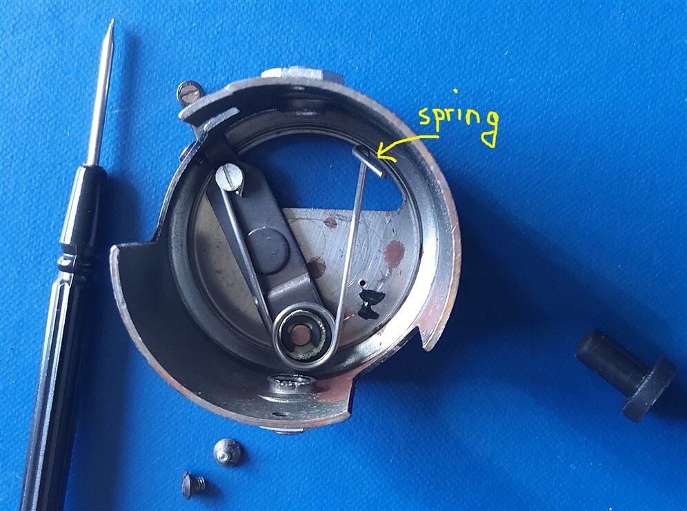

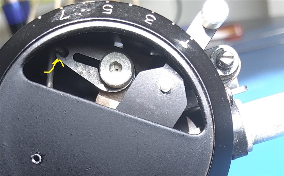

    I got the most difficult parts back together now. When you (try to) put the arm back in the bearings, you have to do that with the housing on (but not screwed in place). And try to catch a spring near the top of the housing. While not pinching the wires.
    I tried it about 10 times this morning and it failed. Went for a trip to the city, and retried. 3rd attempt was successful:
    This is the spring:

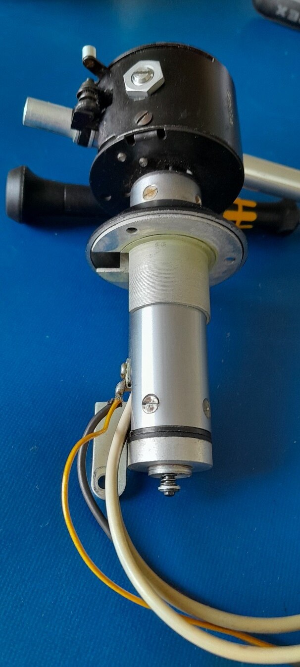

    colporteur over 2 years ago in reply to Jan Cumps
    Is the top solder work OEM? If yes, I hope it was a Monday assembled after a party weekend because it is poor.
    Jan Cumps over 2 years ago in reply to anniel747
    The new part is synthetic. And the old one was beyond rejuvenation - it pulverised.
    Jan Cumps over 2 years ago in reply to colporteur
    Might have been done by some mid-70s unskilled DJ.
    It had a mono cartridge mounted, so I guess it was used by a local pirate radio station or the likes...
