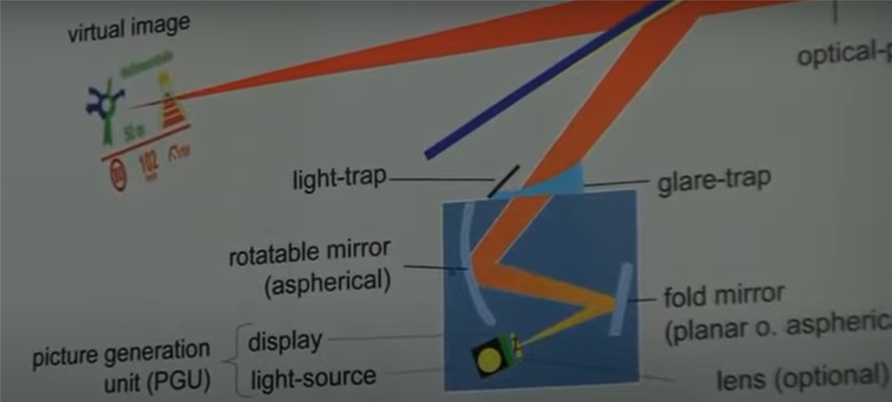

    It looks like a car HUD is very similar to that DIY hololens, just that it is upside down and uses an extra fold mirror to make it more compact for the dashboard.

    The DIY hololens looks like it would give you the most flexibility as to what can be displayed, however as it is inside the helmet, most people will never get to see that aspect when viewed from the outside, so you could be spending a lot of time on something that isn't actually visible. However, equally, if it helps you move and react to your environment, then it may pay off in other ways.
    Also it will depend on how important is is for people to be able to see your eyes from the outside through the visor as you have to have the 45degree mirror for the Pepper's Ghost effect to work. Some pictures show the character's eyes quite visible behind the visor, others just show the green visor without the eyes.
    Image brightness may be an issue, so you might need to use a high brightness display screen to see it when augmenting the view outside.

    I think you will have a lot more flexibility with fan placement than with the display, so if you really want the DIY hololens then that will likely have to be positioned first, then other stuff worked around it. Fans come in all sorts of shapes and sizes and airflow can be ducted as well.
    The DIY hololens will likely have three main requirements. The vertical display screen, the upper 45degree mirror/lens, and the lower 45degree transparent reflection screen that you will look through which will need to be at eye level.
    You may be able to place the display screen horizontally and place a lens below it then flip the image on the display. This would potentially reduce the overall height. A bit more like a teleprompter setup for a video camera. However you need the lens to create the virtual image far enough in front of your eyes to be able to focus on it.
    I think you will need to spend some time having a bit of play with this aspect. Perhaps replicate the DIY hololens in the video to start with to see what it looks like for real and see if the image is bright enough. Then play around with the angles to see if you can come up with something that will work better with the helmet shape.

    The car windshield (and the theatre stage for that matter) has the advantage that it is far enough away for the human eye to be able to focus on it.
    Anything inside a helmet will likely require some additional optical trickery to move the perceived focus point outside of the helmet.
    Virtual images
    http://hyperphysics.phy-astr.gsu.edu/hbase/geoopt/image2.html#c1

    Yeah this is doing the 'peppers ghost' effect, and you can see similar with car projectors
    https://www.theverge.com/2014/8/5/5970705/this-tiny-projector-puts-smartphone-apps-on-your-cars-windshield
    I think you'd benefit from looking for and buying a suitable small screen that works with your hardware of choice, and then you can try finding angles that work with the confined space of your helmet Amethyst - the simple act of angling the screen at say, your visor, would work for a heads up display in most cases and then you need a way to mount it.
    It may take some experimentation, and there might already be similar solutions for motorcycle helmets because that's kinda similar but I don't have any concepts on hand right now.
