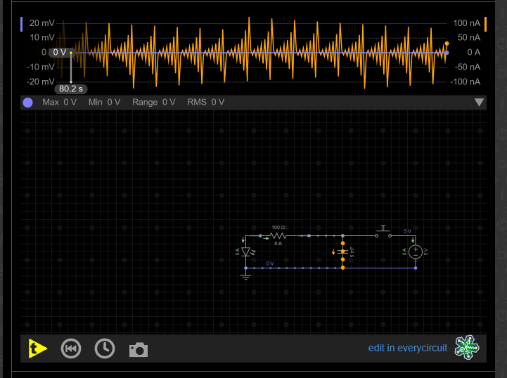

Hello everyone!
I've started to discover an exciting world of electronics and ICs
But there is one thing that bothers me after I've created it  Sweat smile
Here is a link to the circuit https://everycircuit.com/circuit/5216254553751552/capacitor-with-led
1. I can't get why there is some phantom behavior before I apply current to the scheme it appears around 10 seconds after starting the simulation
2. Why is the current continues to flow after the capacitor is discharged
Thank you!

    do I see correctly that it is 100nA peak when working current is about 50mA? I would think about rounding errors or problems with floating point representation...

    Its definitely a bug! I don't know anything about this simulator so I can't say. Maybe the LED model is discontinuous at 0V, I don't know...
    In almost all other spice simulators there is a gmin between nodes, typically 1 GOhm.
    Its numerically unstable near the 0V operating point...
