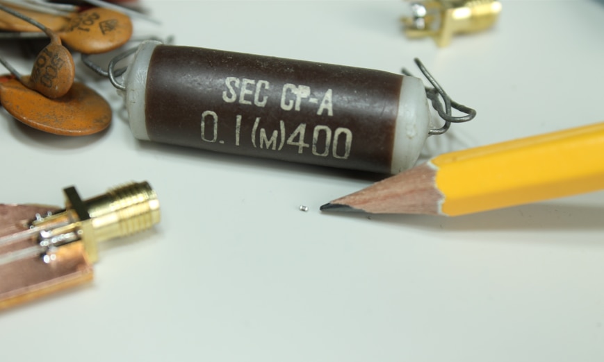

Featured: Two 100 nF capacitors:

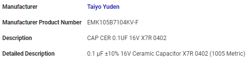

The tiny capacitor at the tip of the pencil is a jelly bean 0402 100nF capacitor, specifically a EMK105B7104KV

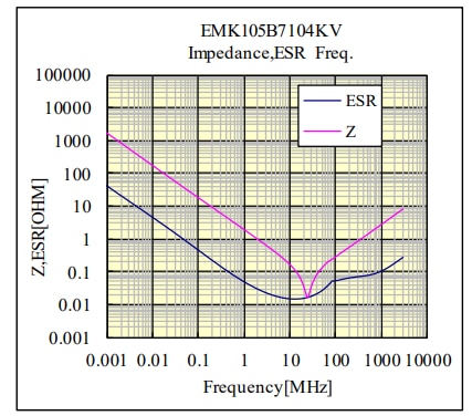

Here is the capacitors typical impedance (presumably 0V DC bias):

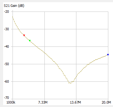

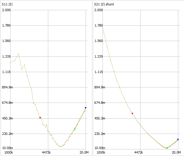

I'll test the impedance of my little 0402 capacitor using my nanovna in a 2-port shunt impedance topology.
Ultra-Low Impedance Measurements Using 2-Port Measurements

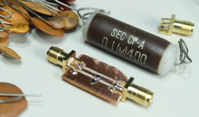

I cut the test coupon with snips (sorry for the rough edges).
The self resonance frequency was measured at 13 MHz. My test coupon has very poor grounding, so I'll happily shift the blame on to the test setup adding a small additional amount of inductance.
I recorded a minimum ESR of 23.6 mOhms at 13 MHz, close enough.
As pretty impressive a sub $100 VNA is measuring 10's of milliohms at 10 MHz. I am certainly running out of dynamic range with the nanovna, it would be a struggle to measure a few milliohms.

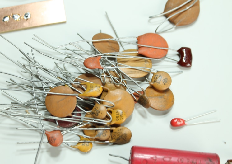

Big Brown Blob
The giant brown capacitor was pulled out of a junk box and is presumably a 100 nF 400V wax capacitors from many decades ago....
The lead inductance of the wax capacitor isn't doing it any favors, the DUT hit self resonance at 2.2 MHz.
An ESL of 40 nH, yikes! Maybe not a great choice for bypassing a high-speed digital IC.
The minimum ESR recorded was 168 mOhms, a bit of a disappointment as well.

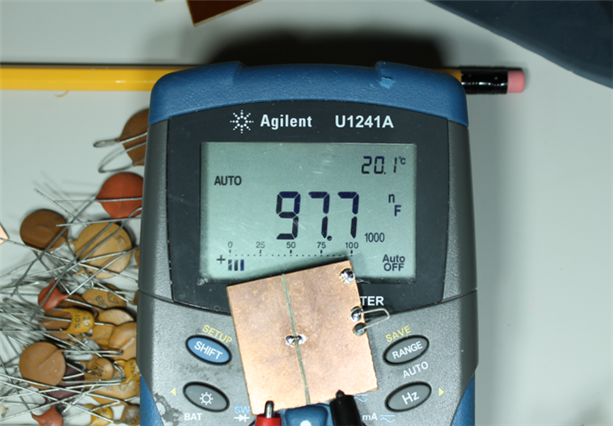

    I put another 100 nF MLCC on a test coupon for easy probing. It started life at 97.7 nF
    It was just starting to breakdown at 250V
    It was breaking down before reaching 500V, it clamped the output of my insulation tester to 433V (can't remember the current limit). After being subject to severe electrical overstress, 50 nF disappeared...

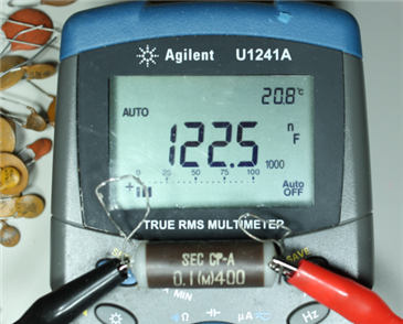

    The brown blob has a capacitance of

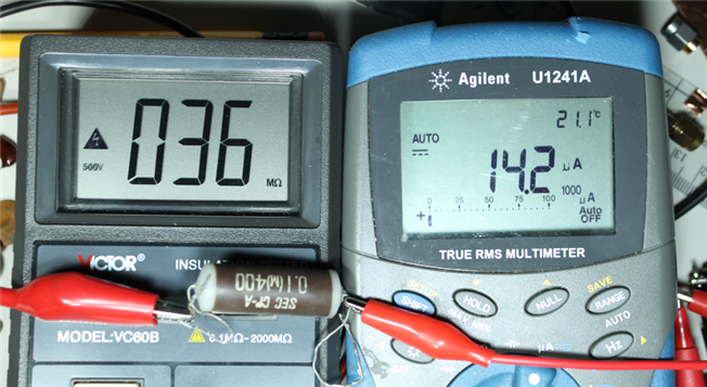

    The brown blob didn't get too fused about a 500V DC bias.
    Though, it was a little bit leaky, passing 14.2uA at 500V...

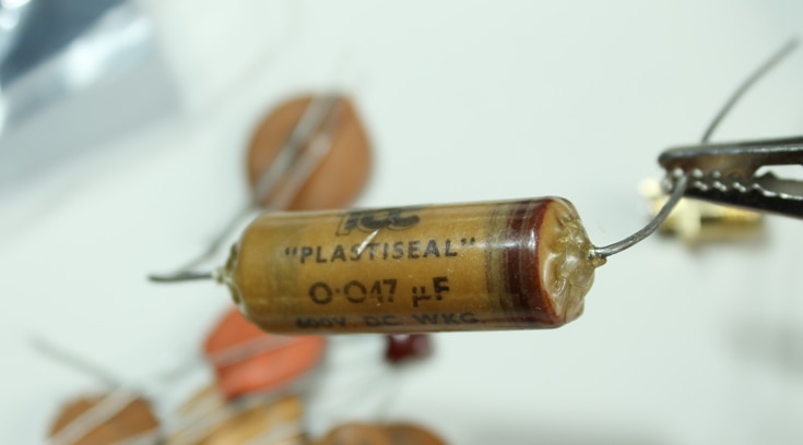

    A "Plastiseal" capacitor
    Made in Flag ca
  • scottiebabe
    scottiebabe over 3 years ago in reply to dougw
    lol I was hopping I had a 100 nF disc to give a more realistic comparison
    If I find one, I'll give it a test.
