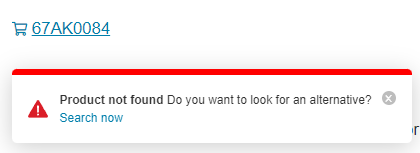

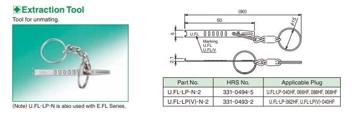

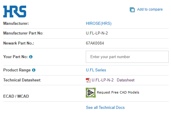

u.FL connectors are just a pain. Connector manufactures sell an extraction tool for these wonderful RF connectors, such as
67AK0084  67AK0084  67AK0084
Pricey.

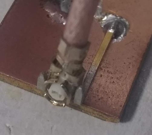

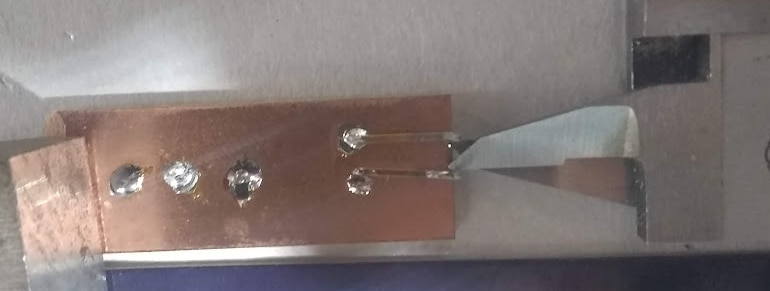

How about two 100'thou SMD header pins soldered for a 2.5mm gap between the pins?
Hmm, these photos scream of potato vision...
I'll try it for a bit and see if it works out..
Other ideas?

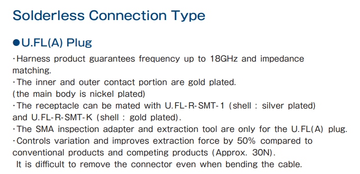

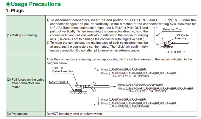

Hirose Recommendations:
https://www.farnell.com/datasheets/3926994.pdf
Testing. Why do pasted images get scaled? Trying a small one.

    Extremely detailed pics! Did you put them under a microscope to shoot?
  • md_steve
    md_steve over 3 years ago in reply to scottiebabe
    Great pictures! Now I see why so many of them have been broken in use.

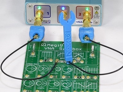

    Sparkfun has an insertion/removal tool that I may give a try - U.FL Push/Pull Tool.
  • scottiebabe
    scottiebabe over 3 years ago in reply to koudelad
    Ooo, aww, nice looking VNA, VNA Sandbox, and uFL tool! Thank you kindly for sharing
  • koudelad
    koudelad over 3 years ago
    I use this (got it free at Embedded World several years ago): https://www.megiq.com/shop/accessories/sma-ufl-tool
    Since it is 3D printed, I believe there will be a model somewhere or feel free to draw your own :)
