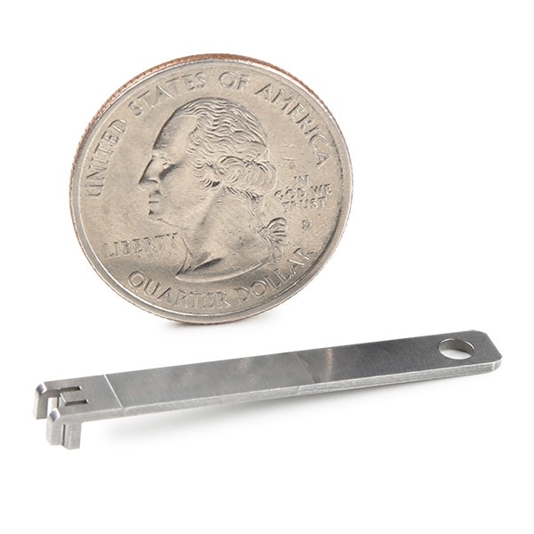

u.FL connectors are just a pain. Connector manufactures sell an extraction tool for these wonderful RF connectors, such as
67AK0084  67AK0084  67AK0084
Pricey.

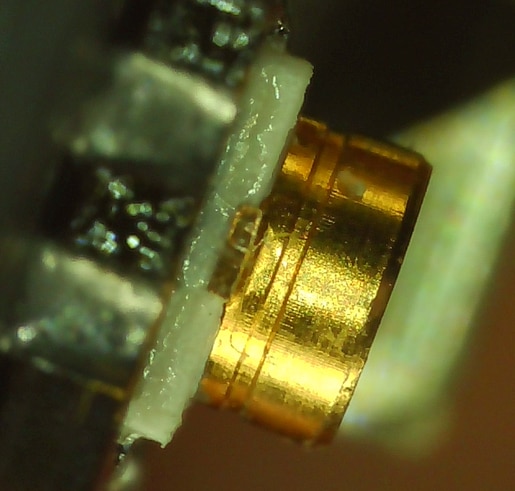

How about two 100'thou SMD header pins soldered for a 2.5mm gap between the pins?
Hmm, these photos scream of potato vision...
I'll try it for a bit and see if it works out..

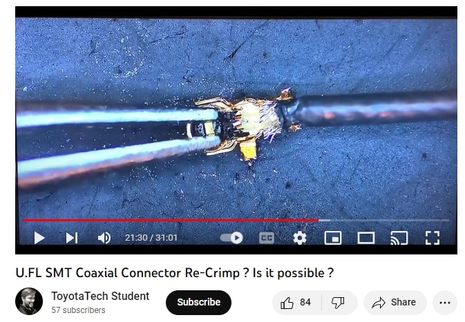

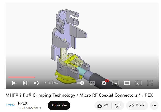

  • scottiebabe
    scottiebabe over 3 years ago
    Yay! Thank you.
  • scottiebabe

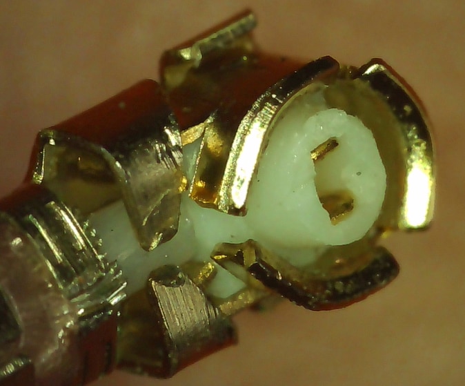

    scottiebabe over 3 years ago in reply to Gough Lui

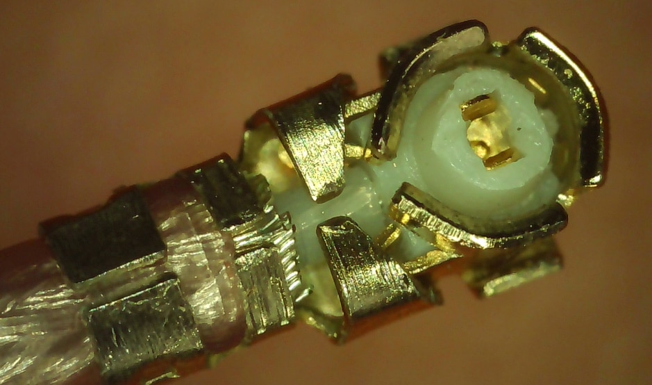

    Yes! The horror:
    Excellent alternate suggestions, thank you.
  • scottiebabe
    Motivation: my fingers were getting sore cycling through SOLT calibrations

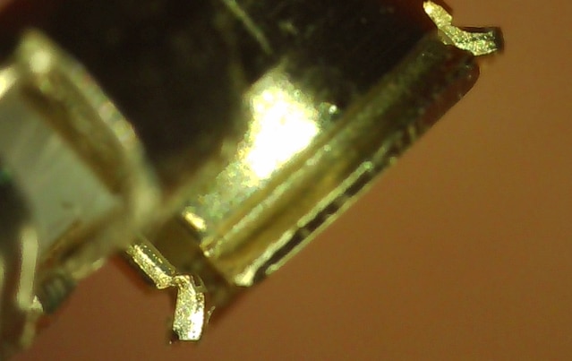

  • scottiebabe

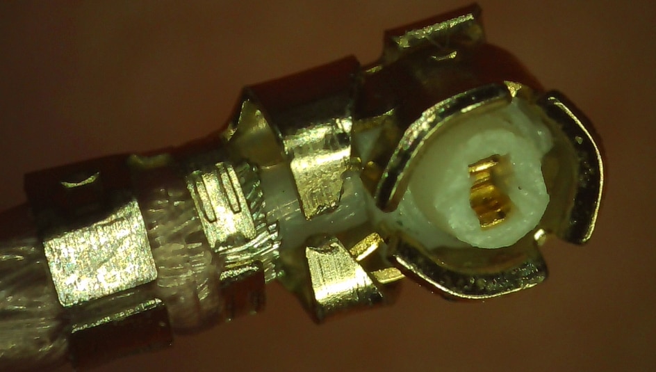

    What am I doing wrong:
