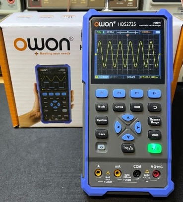

    Thank you for the find words. I will add a quadrac to my next order and post a scope-shot with my scopemeter.

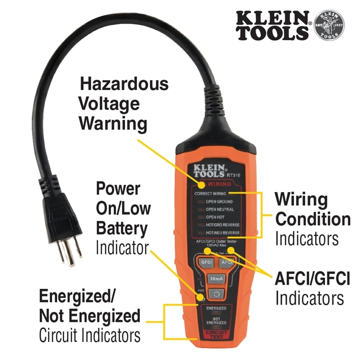

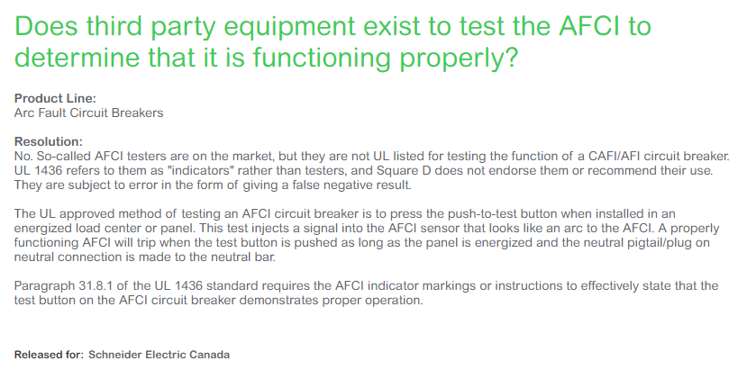

    I have only heard stories about them nuisance tripping...
    I wonder what an AFCI testers is? maybe a shortwave rf transmitter...
  • scottiebabe
    scottiebabe over 2 years ago in reply to scottiebabe
    Not sure looked a few patents for generating an AFCI test current
    image image
    https://patents.google.com/patent/US8179145
