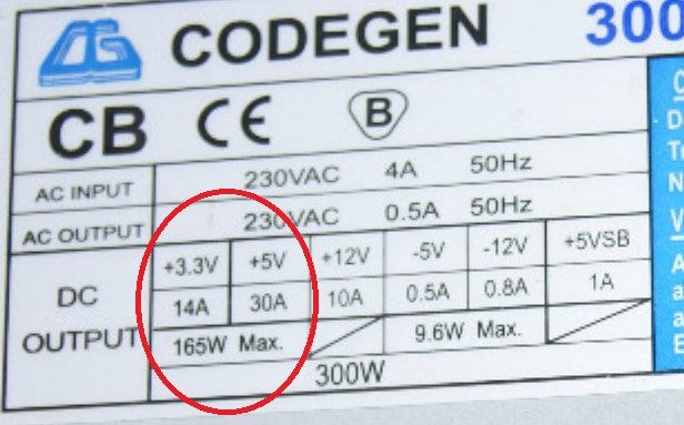

    I have observed that ATX supplies parameters have changed sometime in the past - old ones provide most of the power on 3.3V/5V rails, but modern ones on 12V - to the level that 500W modern PSU cannot power PC of old (several years ago, for some tests we have been building PC with power-hungry GPU, but using existing [old] hardware - and the PC was not able to power up using a brand-new PSU. We had to use dual PSU configuration - old one was powering motherboard and a new one was used as an auxiliary power for the GPU)
    So - if the machine is very old, not only power but power distribution between voltages is to be checked
  • JWx
    JWx over 2 years ago in reply to JWx
    for example: upgrade from this 300W PSU
    300W PSU
    to this 500W PSU
    500W PSU
    can be a downgrade depending on load parameters...
