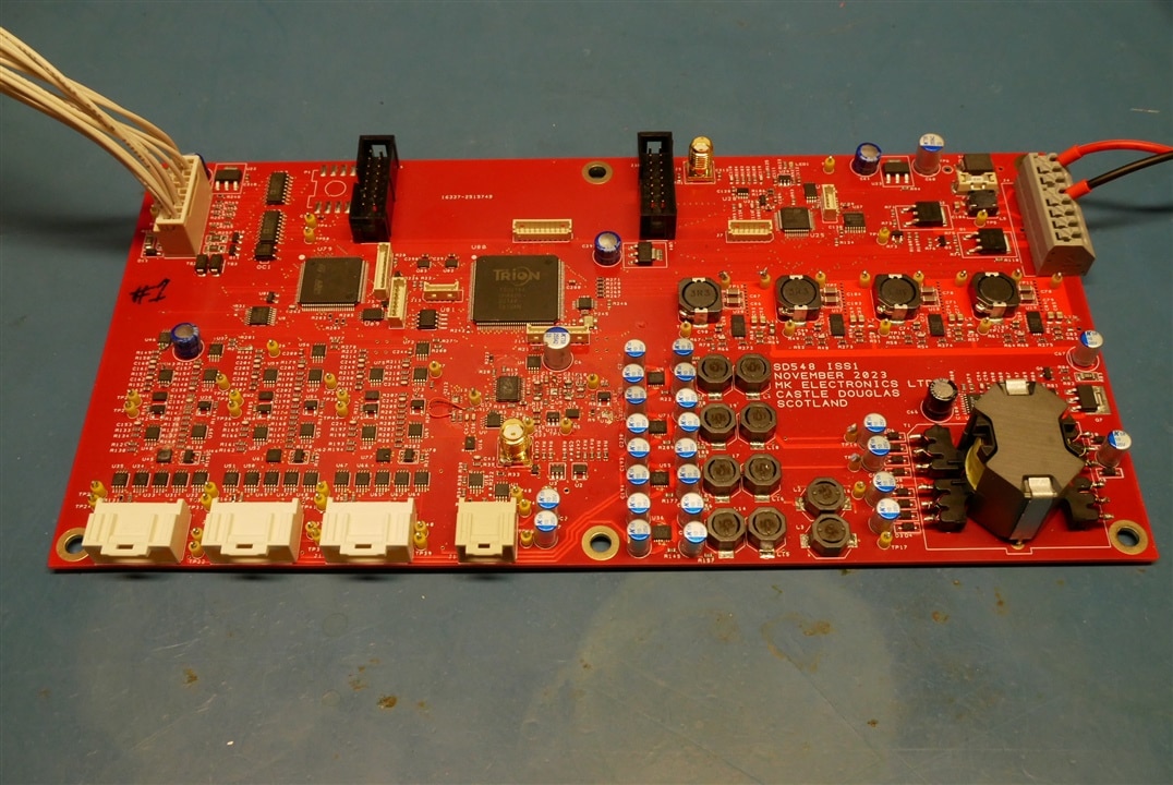

    When you plan power supply or Driver circuits do you think of the life of caps in the machine
    Actually, yes.
    The board in the picture will have an easy life - it's planned existence is that, after development and testing, it's powered up life time will be << 1000 hours.
    But that is unusual.
    You can make your caps last longer by running them cool and de-rating by large factors for voltage and ripple. 1000 hour rated cheap caps often last a very long time in low stress applications.
    The realities of power design often result in large stress on capacitors but when the cost of a big 10000 hour 450V cap can exceed £100 you can see why they don't end up in washing machines.
    Another thing to watch out for is that the capacitance of ceramic capacitors (especially Y5U and X5R types) can be as little as 20% of nominal value at the full rated voltage and less than 50% of nominal at 50% of rated voltage.
    Good point about the dust !
    Just been working on a design with 80V supply and lots of tracks -  0.15mm track and gap rules definitely not suitable !

    Hello, My job for the last 38years is repairing electronics. when dealing with domestic equipment which can sometimes get circuits. But when i am doing industrial modules i have never got circuits. so using data sheets and my own test points works. one thing that gets me is when designed they put small caps running 24/7 in a standby power supply that should be away from heat. Where i have found bigger caps of the same value last longer.
    then a motor driver ic with multiple legs would die because it has high voltage then dust then moisture.
    running 24/7 there is 8760 hours in the first year of warrantee
    how many caps used are better than 2,000 hours.
