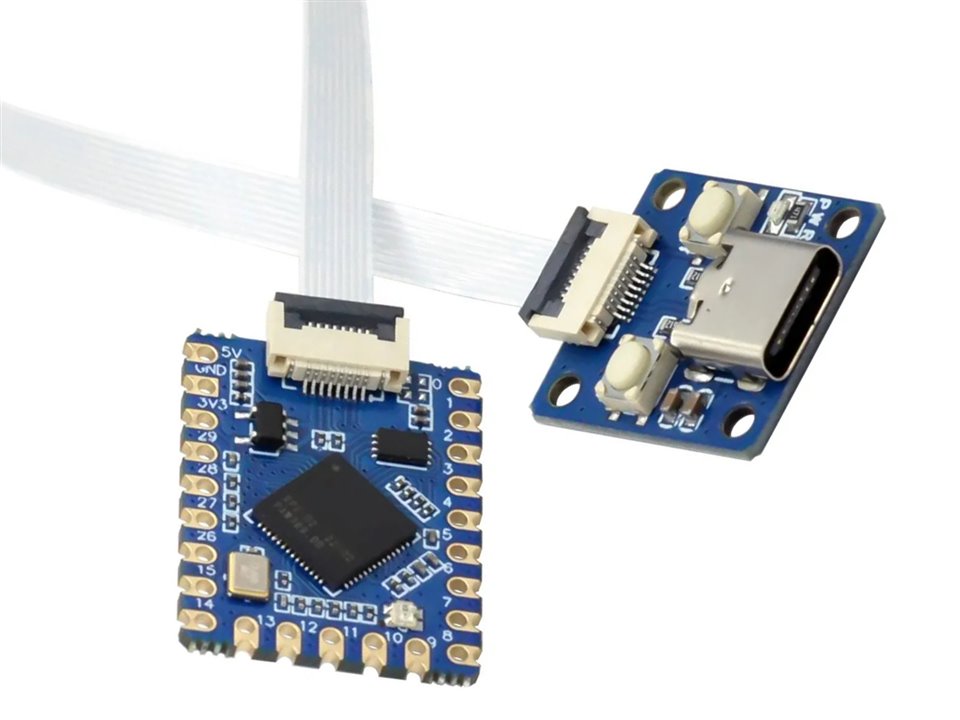

At present, I’m working on an RC plane project where communication is handled via the NRF24L01 module. Thus far, I have thought to utilize an Arduino Nano, however I find it a bit oversized for the limited space in my build. I need some alternatives that are smaller in size and are able to function seamlessly with the NRF24L01.
 Is there anyone who has used this form of compact microcontroller for such a purpose? Or are there any other microcontrollers or chips that you would suggest?

    You could try a dev board using the NRF52840 chipset as you can potentially use this to communicate with a NRF24L01
    https://devzone.nordicsemi.com/f/nordic-q-a/99452/nrf52840-to-nrf24l01-communication-with-static-payloads
    There is the Xiao NRF52840 dev board available or you could try this module from Waveshare. No doubt there are other small modules about.
    https://www.waveshare.com/core52840.htm
