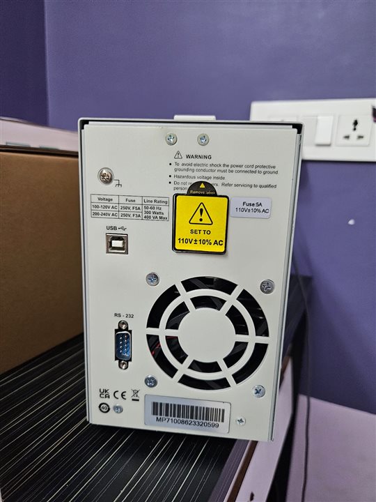

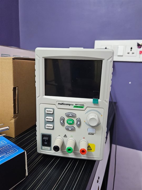

As the title suggests, I need to change the input AC voltage of Multicomp Pro MP710086 bench top power supply from 110V to 240V AC.
I received this power supply as one of the prizes in the Hackster holidays giveaway but they sent me a model with 110V AC operating supply.
I tried taking a look at the back panel and there doesn't seem to be a voltage change switch. Is there any switch inside the supply? Or any other way to change the input voltage?
I cannot use it as the supply in my country is 240V AC.
Pictures for reference below.
  • rsjawale24
    0 rsjawale24 over 1 year ago in reply to electronicbiker
    The image is quite clear for me. Maybe some issue with quality when uploaded here.
    The D panel is for RS232 communication programming/control through SCPI commands I guess. It also communicates via USB. I checked the website as well, they clearly have two different models of the project one for 110V AC and another for 230 V AC

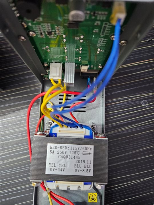

    Unfortunately, the power supply transformer doesn't have any label. But other products do have a label on the transformer.
  • rsjawale24
    0 rsjawale24 over 1 year ago in reply to Jan Cumps
    No, the transformer is specifically designed for 110V AC input. The power supply has a toroidal transformer with no specs written on it.
    For example- I opened up the soldering station and this is what is written on the transformer.
    All these units also come with US plugs. I have modular socket at my home so plugs are not an issue but the operating voltage is.
    The transformer takes 110V AC, steps down to 24V AC for the soldering iron and 9V AC for the PCB Panel with LCD. There is a small bridge rectifier near the 9V connector.
    I'm thinking, if I can simply replace this transformer with a 240V AC to 24V AC at least the soldering iron will work and I will bypass the AC connector and connect 9VDC supply to the panel.

    0 Jan Cumps over 1 year ago
    Looks like the only task is to change the fuse:
  • electronicbiker
    0 electronicbiker over 1 year ago
    You could use an external 2:1 step-down auto-transformer to provide 110V AC to the PSU from your 240V AC mains supply. They have a tendency to hum slightly and the regulation isn't too good on the smaller ones. On the up side you don't need to make any changes to the PSU, so it won't affect any guarantees or warranties. The main problem with supplying an answer to this particular problem is that the photograph of the back panel is slightly blurred which makes all the legends and labels difficult to read to say the least. I don't know what the 9-way 'D' connector is for, nor do I know what the rectangular connector underneath the ratings table is for, the one that looks like an old-fashioned printer input socket. A close-up clear photo of the ratings table would be very useful, as would one of all the wording above and to the right of the yellow 'danger' label.

    0 acdc90 over 1 year ago in reply to rsjawale24
    was there any numbers on the transformer
    could you identify the primary wires
    do you have photos of top and bottom of board
