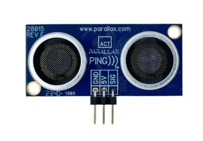

    That's wonderful! It is incredible how affordable electronics and electronic as a hobby in general has become.
    I believe parallax introduced the ping))) sensor module in the early 2000s for $30
